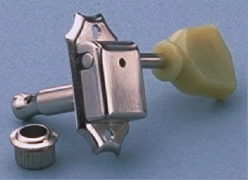

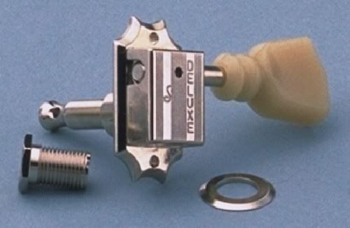

If your current tuners are like this, with a hexagonal nut and washer, the Grovers should fit with no modification.  If the Grovers are full-size  Rotomatics, even the screw holes should line up.
If your current tuners are like the one below, with a press-in bushing, then you'll need to enlarge the holes as Phil said:

Brill!!! My tuners have the hexagonal nut and washer... Strangely enough though, My tuner is exactly like the first one if it wasn't for the tulip head which is as per the second pic. Does it change anything to the ending of the story?

No, same ending!  :)
Most new Kluson-style tuners have the single-ring tulip head.  I just looked at my Gibson set and they're the same as yours.  I couldn't find a good pic of the Gibsons so I used that Schaller one.
