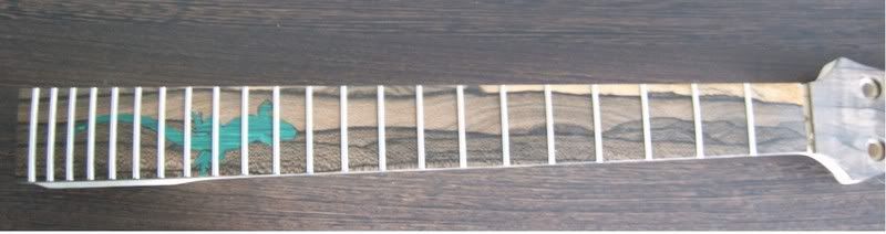

Warmoth Strat options
« Reply #29 on: January 13, 2008, 08:31:50 PM »
here are my latest ziracote boards
I love the stuff!!
