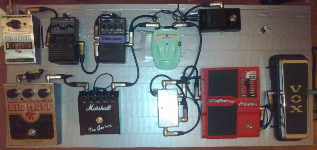

« Reply #157 on: January 25, 2011, 08:14:42 PM »
Hi,
Built my first pedal board at the weekend. All powered (minus the whammy) by an Voodoo Labs PP2. Secured the power to the underside of the board.
Really happy with it, was getting a slight hum which I couldn't pin down. Added a bypass loop for the whammy today and now when the Guv'nor, whammy, bypass pedal or the muff are engaged the hum is gone.
So I am currently leaving the bypass pedal engaged to eliminate the hum and using the whammy's on/off as usual.
I bought the bypass to eliminate the whammy's suck of tone but is proving better as a hum cancelling device. Any ideas on this anyone???
Chain is Vox Wah, Digitech Whammy, Dano vibe, Marshall Guv'nor, EH Big Muff, Flanger, EQ, EH Holy Grail Reverb.  Tuner comes off the second output on the Flanger.

« Reply #158 on: January 26, 2011, 01:43:11 PM »
pretty sure the whammy's Power supply is causing the hum. can you try running it on batteries to confirm?
i know the stock dunlop psu for wah's hums terribly compared to the visual sound adaptor or even a boss psa-120

« Reply #159 on: January 26, 2011, 06:16:54 PM »
I read somewhere that the pedal power 2 isn't suitable for the holy grail and produces a hum.  I think the holy grail has a higher current draw than the PP2 can provide or something.  Try taking it out of the chain and see if the hum's still there.
