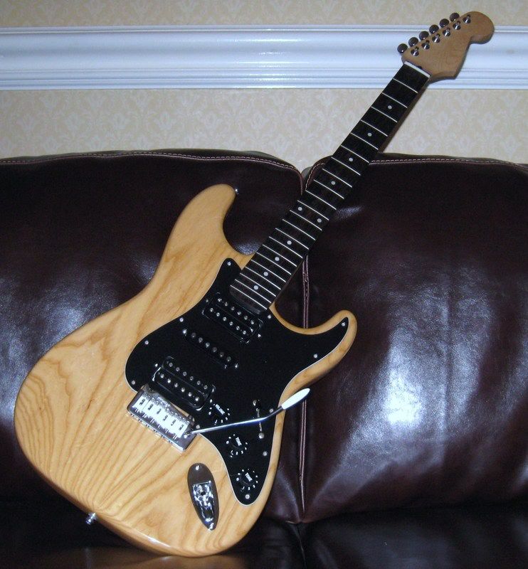

Hiya
I'm putting together a h-s-h super strat, shown below. Nailbomb bridge (4 core), Mothers Milk middle and Mule neck (2 core)
I've got some good pots to use for the volume and tone (250K) but should I use these or get some 500K ones as it's loaded mainly with humbuckers ?
Thanks
Chris
