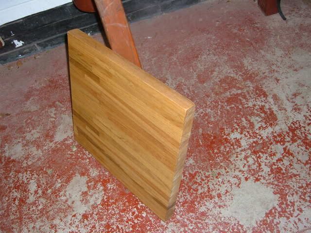

I was cleaning out my garage this morning and I saw this:
Dimensions are 42x500x520 mm.
It's a cut off from an oak kitchen work surface I had fitted a few years ago, I'd forgotten all about it.  But now I'm thinking - LP Junior shape?  Cheap neck off Ebay?  A couple of MQs?
What do you guys think?  I KNOW it will be incredibly heavy, but that aside, will it work?

I don't see why not - it could be a fun experiment if nothing else.
But.... I just wonder if you'll end up with a boat anchor which may not sound too great thanks to all those different pieces of wood.... in which case is it worth all the effort?

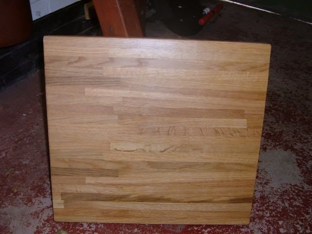

now i have nothing against lots of pieces of wood being stuck together to make a body even if its not something i am interested in using myself... but the problem i see here is that some are joined end to end and really you want a continuous piece for the length guitar because end grain jons are weak - but draw some shapes on and see where that end grain ends up.. if you can get them all behind the bridge it might not be a problem

Good point about the end joints, Wez...  I think that I can get some continuity.

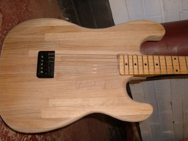

So.
This is what I've been doing with myself...
The starting point.
Shape was donated by my Charvel... pretty much Strat-ish.

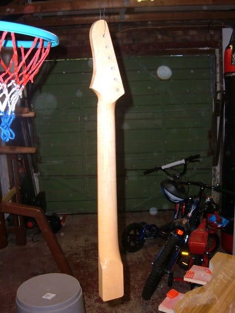

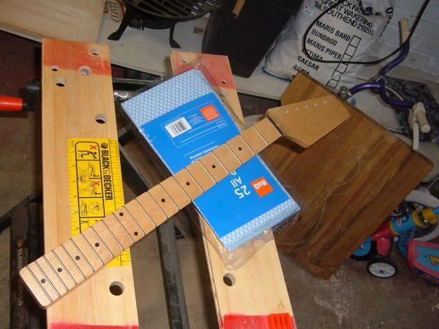

Neck was no-name from Ebay, Canadian rock maple neck and fretboard.
Sanded and danish-oiled

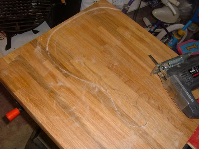

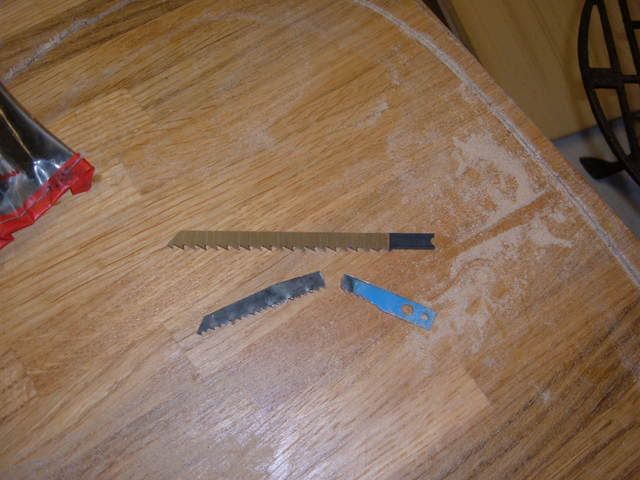

Jigsaw struggled cutting the body shape...
... badly!

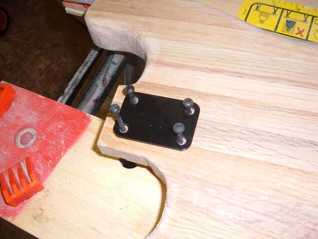

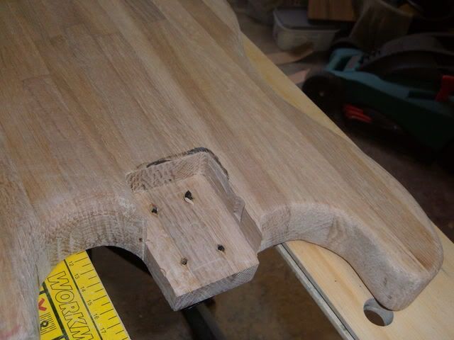

Routed neck pocked - I hated doing this, and there are many gaps.
Checking that the neck fitted in and everything was straight - it was, against all the odds..!

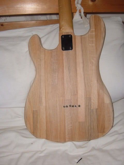

Mock up with bridge and knobs.
Fitting the neck, tuners on (but wonkey as f*ck)
Dodgy string ferrules
Strings fitted, tuned and tested!
More of the same...
...and again...
... and the youngest kicking some arse.
Well, that's it so far.  I strung it with some Ernie Ball 9s that I had lying around, and it actually sounds pretty good - intonation is spot on, the action isn't half bad, plays really well!
It's rough as hell though - chips and gaps all over it.  It's sloppy and a bit of a slob.  Like me.
I love it!
Next step is to strip it down again and go through the fine sanding, then Danish oil and wax the body.  The I guess some electrics.
