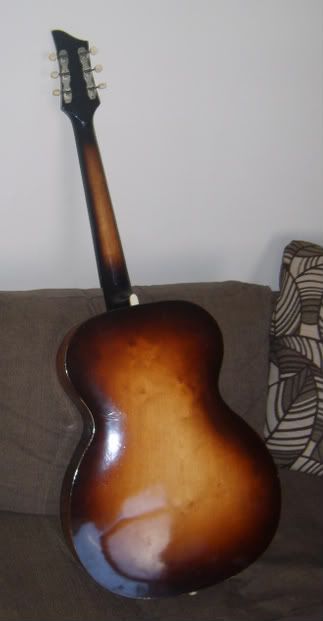

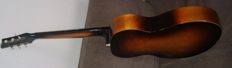

well my ebay archtop finally turned up this morning....
first impressions, quite impressed.  i was expecting a real project  but its in quite good nick.
the neck has just the right amount of relief so i dont think i will need to add a truss rod or graphite reinforcement and it doesnt currently need a neck reset as the action is more than acceptable for an acoustic... although there isnt much adjustment left so it may be due for a reset in the next few years or so if things change much
the major issue is the tuners which wont currently tune it up fully to pitch so its tuned down at the moment... so the first job is to remove those and give them a good service.  i am happy to say the gears look to be in good condition  and the buttons are mostly solid.  once i have removed them i will give the cracks in the buttons a superglue bath and re buff them and i will give the gears a good oiling - that should fix any issues there.  obviously when i can get it up to pitch properly i may not be so happy with the neck relief but i cant see it moving much as its very chunky - either way i dont mind.
the frets are old brass ones, quite worn but they dont need replacing just yet, just a bit of a recrown and polish - the zero fret has been replaced at some point already.. i do need to move the bridge forward when i restring it as its about 1 cm to far back - its like someone measured the scale length from the nut rather than the zero fret :?

anyway, i gave the tuners a good seeing to and they are working a bit better.. still a bit of a work out to get it tuned up but i am at least more confident in the strength of the buttons.  I might change it at some point but not a priority
but it does mean i have it tuned to E rather than D  and i moved the bridge to the right spot to fix the intonation and its performing a lot better and sounding really nice.  will get some new strings for it tomorrow if the neck is still mostly straight by morning!!
