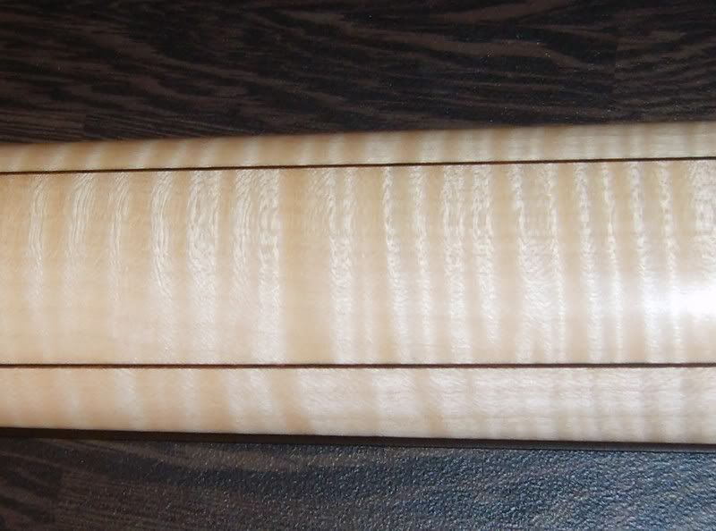

thats the stuff, gunstock are usually soemthing like walnut which is naturally dark - maple is naturally light and will only go a bit darker with the oil.  this is a freshly oiled maple neck with a few coats:
hardly any tint at all... but it may get more vintagey amber as it ages
finish sanding up to 800 should be pretty good- i prefer 1500 but i dont think it makes that much difference once you are rubbing it down with 0000 wire wool

birchwood casey tru-oil gun stock finish.... exactly what i used in the picture of the flamed maple neck i posted above
