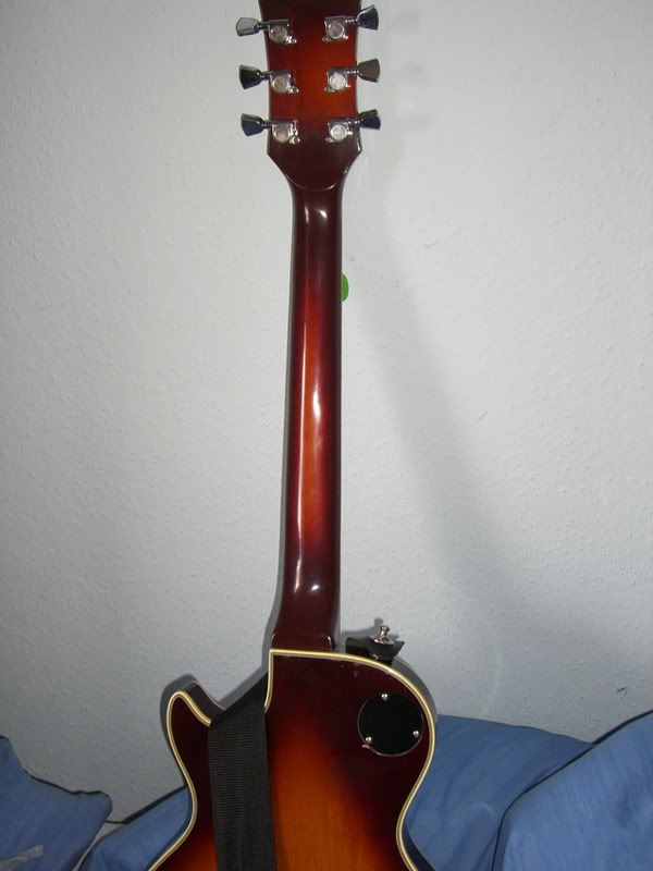

Just got my Pearl back from the tech after about 3 weeks of him having it - he's done quite a lot of work to it. Basically it fell off my stand one day and the neck join cracked a bit so I thought it'd be a good opportunity for a setup etc to be done because it didnt play amazingly anyway.
Well its totally transformed the guitar :D It wasnt terrible before it went in but not the greatest player either. He's given it a full fret dress by the looks of things (I thought he was only going to do the upper ones as I requested!) as they were causing some notes to choke so now above 17th fret sustain much better :) When he was putting glue in he realised that it hardly had any glue in at all, opened it up and found that it was secured on pretty solidly by two dowels so the neck wasnt moving but he put some glue in the join anyway to keep it all solid.. some of the glue ended up seeping out and he said it made a bloody mess of the neck so he refinished it all for free :) The finish he's put on is way smoother and faster than before. Heres a pic of it, matches well:
Overall I'm really pleased and I think this guitar plays better than my Epiphone now though the action is a bit lower than I'm used to so I may raise it a little bit. Oh and I only paid £120 for the whole thing, great price for the job he's done.

Looks superb Tom - glad it worked out OK for you  :)
The refinish looks really good!
Yep, you can hardly see where the crack in the lacquer was before now. I'm really pleased with it - the colour matches perfectly. Trying to get a good pic now but my camera doesnt focus too well up close.
