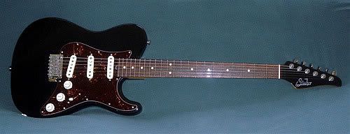

The custom shop also makes the opposite, a Strat/Tele hybrid which I have seen John Mayer using.  It looks pretty dire in this pic, but is better in the flesh.
It's horrible in that colour, but I just remembered there's a similar Suhr model which looks pretty funky:
(Edit:  the Suhr has a slimmer bottom horn and a side mounted jack, which improves the appearance a lot, somehow.)
