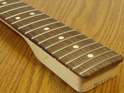

Still trying to find a neck for my Strat and (ignoring Warmoth for the moment) I've been looking at Fender necks on eBay.  There seems to be a huge variance in the appearance of rosewood fingerboards.  Some look beautiful and glossy like this:

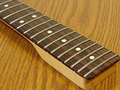

Others look hideous and dry like this:
Or even this:
The third one is an extreme example, most don't look anywhere near that bad, but those are all American Fender necks.   In general the Deluxes look amazing, the American Standards look good and the Highway Ones look dry - but it doesn't seem to be a simple case of different "grades" of timber, sometimes the colour and grain patterns are very similar but the H1s still look dry.
Now of course some lemon oil or similar would make those dry necks look instantly better, but I'm not really talking about that.  Can anything else be done to "repair" the dry looking wood?  Would simply sanding with finer grades of paper, for example, improve things?  Is there a way to "buff" the bare wood and give it a shine?
Or is it a simple case of "bad looking = bad" and there's nothing to be done?

I use fret doctor for that, it made my epiphones board look pretty nice, worked quite well on the rosewood tailpiece/bridge on my acoustic as well.

most will polish up a bit more with wire wool and elbow grease.  for the really dry ones i would use an oil that actually sets in the wood like danish oil.  give it a few coats and buff of the excess after 5 minutes, then polish with wire wool after a few days
i dont think its going to be bad just because it lacks some of the natural oils but it might mean a little more care and maintenance
