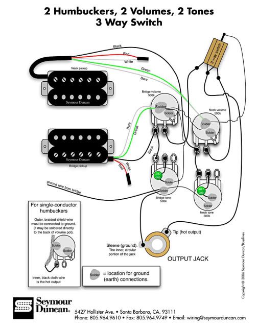

I'm following the SD wiring diagram, and it just doesn't seem to be working.  I've already de-soldered it all and taken it all apart - just redone the wiring and it STILL doesn't work!
I know it's an obvious thing to say, but the wiring all LOOKS good...
I think that it might the DiMarzio 3 way selector switch; I think that I might be wiring that up badly.  Maybe I'm not understanding it?  I assumed that you connect the lug that connects to the outside bit to earth, the two lugs either side to the hot wire from the pickups, then join the two remaining lugs together and feed them to the hot jack...  isn't that right?
Gonna have a cup of tea and another crack at it.  I'm sure I'll get there...
That all sounds OK (I'm assuming the "lug that connects to the outside bit" is the thicker one that's part of the main metal body of the switch).
Are you getting any sound/noise/buzzing at all, or total silence?
If it's the latter, make sure the hot lug of the jack isn't touching any ground wire, shielding paint etc - I've made that mistake before and it kills the signal stone dead.

Had a cup, sat back and assessed what I was doing, realised that I hadn't linked up a couple of pots (earthing the backs of them).
Sheesh!
Not sure I understand why they would need a DIRECT connection, but there you go.
Anyway, fixed that, then tested on my trusty Pignose, and all was fine.
Reassembled, got out the old polish, and a go at feeding the fingerboard, dragged everything upstairs, plugged in and...
Same problem.
Brough the whole lot back down again, and had a look - bad soldering on the earth to back of pot that I'd just done!!!
