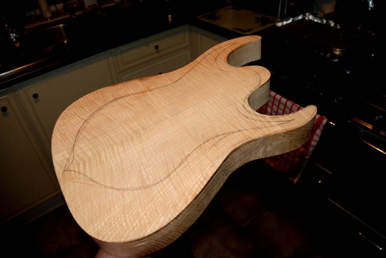

I'm currently building a guitar using some figured english ash, and it's great so far :) Would like to try some english sycamore, perhaps for a les paul cap or something.
I do like that top :)
