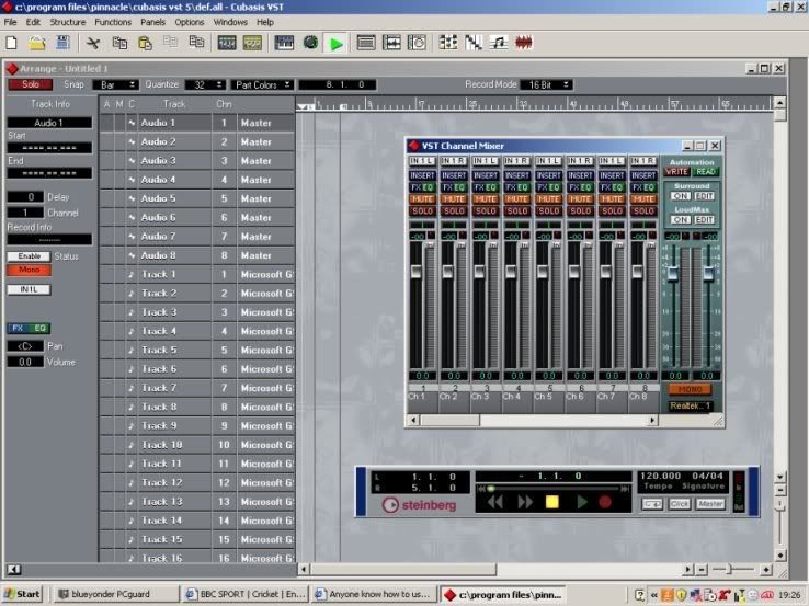

Hi
Ive checked out the program its actually cubasis vst5.
I can't seem to find the red dots etc here's a screen dump of what i'm seeing.
THANKS :D
Ben

« Reply #8 on: February 18, 2009, 08:23:24 PM »
Old school
Never used VST, but do those tracks expand out?

phlip
  • Posts: 319
Re: Anyone know how to use cubase?
« Reply #10 on: February 18, 2009, 09:11:27 PM »
In that Cubasis the 'red dot' is the enable button beside mono in the track properties.

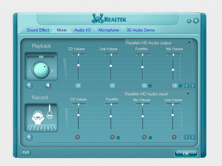

« Reply #11 on: February 18, 2009, 10:41:55 PM »
Thanks for your help
Unfortunately im now even more confused. :(
I tried the help function, which was helpful but didn't address the issue at all.
I then tried the enable button, but rather than being seletable per track it is either selectable for all or none, i.e. it wont isolate any individual track.
here's a screen shot of what im looking at when i click the speaker sign in the bottom right of my comp.
One thing i forgot to mention, if i were to record the click on track one, then guitar on track two, the click recorded on track two would not be in time with that of track one, there's a slight delay.

« Reply #13 on: February 18, 2009, 11:19:11 PM »
Yay!
Finally figured it out! :lol:
Not sure exactly what i did but in the recording control panel you have to select between
CD VOLUME
FRONT MIC
MIC VOLUME
LINE VOLUME
STEREO MIX
Not sure what it was on before, but now ive set it to line volume the problem is solved!
