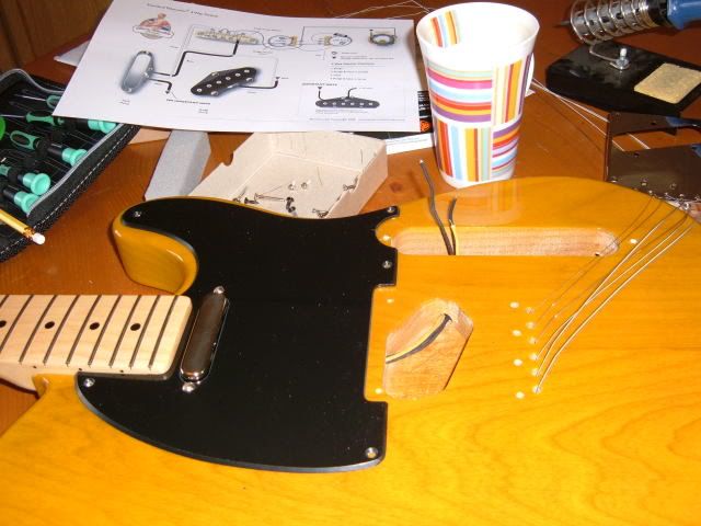

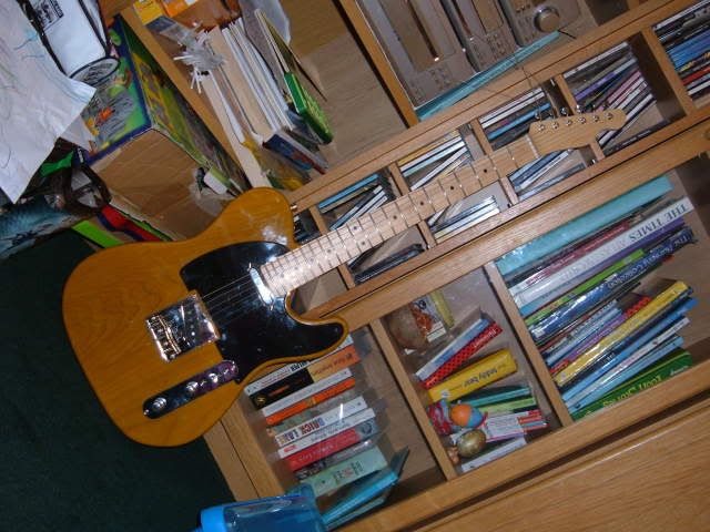

Guess what I've been doing..?

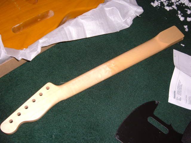

The neck and body are from Axes R Us, and are suprisingly good!  Heavy ash body, 1950's style in butterscotch, all maple neck and fingerboard, nice satin finish to it - perfect, tight fit.  The neck is a very chunky "vintage 'C'", and with medium jumbo frets this suits me very nicely...  Cut and fitted the bone nut myself, which I'm very pleased with!
Bridge is Joe Barden - was looking at Callaham and Glendale, but they're really pricey, and I'm a real tightwad.  The Joe Barden is great, compensated saddles, and the extra screws at the front of the unit.
Tuners are Gotoh vintage with their Height Adjustable Post mechanism - theses are great locking tuners!  Still getting faint ghost harmonics on the high E string, and I'm toying with fitting a string retainer.  Will live with it for a bit and see.
And the pickups are EMGs.
Only joking!!!

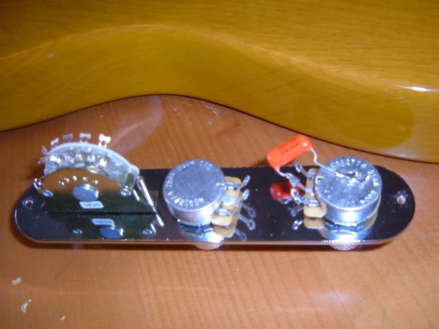

Blackguard Flat 50's, as recommended by Mr Mills.  Wonderful tone - really gritty, loads of bite.  I wired in a 4 was selector, and the 2 pups in series is awesome!!!  In fact, all 4 positions are amazing.  Really sharp in the bridge, bright, twangy and clangy, stratty in the parallel position, and a VERY stratty neck sound!
Got loads of help from this board, as usual, with a special shout out to AndyR, Fernando, PhillyQ and Wez.
Going to spend some time getting used to it, the will record some clips - promise not to play "Whole Lotta Love"...
 :D

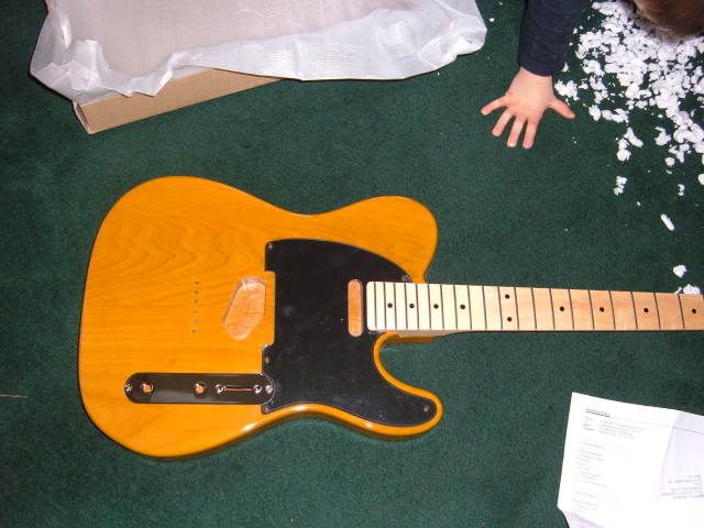

Very nice, my favourite colour scheme on a tele I think :)
In the 2nd pic it looks like your son is throwing up a load of polystyrene :lol:
Yeah, the body and neck came well packed...  Took ages to clear that mess up...
Incidentally, the wiring diagram that I got with these was brilliant - the ones that I got with my Nailbombs and Mules were, quite frankly, rubbish (sorry Tim - not exactly rubbish, but very basic, particularly for an idiot like me...), but the one that came with these was brilliant.  Tim actually sent me a second, one with the 4 way wiring.
Big improvement.

Well, I've been after a more "Fender-ish" guitar for ages - I love my Yam SG with Mules and Charvel with Nailbombs - but I do miss the single coil sound.
So I went to Tin Pan Ally and tried some Telecasters that were in a reasonable price bracket, no more than £700 I think.  And none of them impressed me, I think that the nicest one was a MIM 60s reissue.
I thought about Warmoth, but the exchange rate is really nasty at the moment.  Then I looked around at necks and bodies that I could source in the UK, and bought the neck and body from Axes R Us.  Got the pair for £200, which I think is pretty good value.  It was a bit of a gamble, but I'd have no hesitation in getting a Strat neck and body from them.
Managed to get the bridge and tuners for about £100, PUPs were £125.  Then all the little bits and bobs brought the whole thing in at just under £500, which I think is a bargain given the hardware that's gone into it.
None of it was difficult, just assembly.  Making the nut was the only thing that I'd class as requiring a little skill, but it's fine if you take your time and go steady.
Do it.  You know you want to!!!
