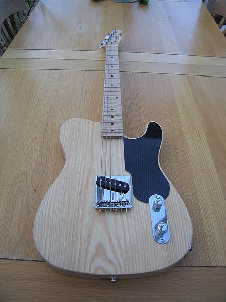

I too love Esquires, and the process of "Esquiring" a Tele is yet another of those nouns that have become verbs in modern lexiconography!
I had an old BSB Squier, which played nicely, but the neck pickup was awful, whereas the bridge one was suprisingly bright and loud. Mine is wired so that the swich does the following. Front;- Tone and volume, Middle;- Volume only, Back;- Stright to jack socket. Very versatile IMO.
I also until recently had a really stripped down Esquire with no pickguard and no controls, which was fun for a while. Homemade pine body, cheap copy neck.
I rebuilt it to look more like this, then sold it
I have another Esquire type, with a Hohner neck and a beech body, which my daughter plays a lot
Esquires are fun guitars!
