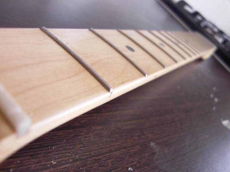

here is the neck pre roundover:
its a maple tele neck from warmoth.  It has been used a little bit and has a coat of oil on it  already.  part of the job on this neck is to get the finish a little more consistent and also do some extra fretwork to help give it a worn in feel.  that will all be done after the roundover.

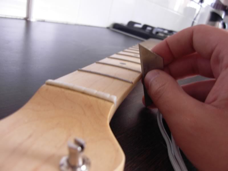

here is how i hold the blade - it starts with the first scr@pes at this angle (Blade nearly flat on fretboard face):

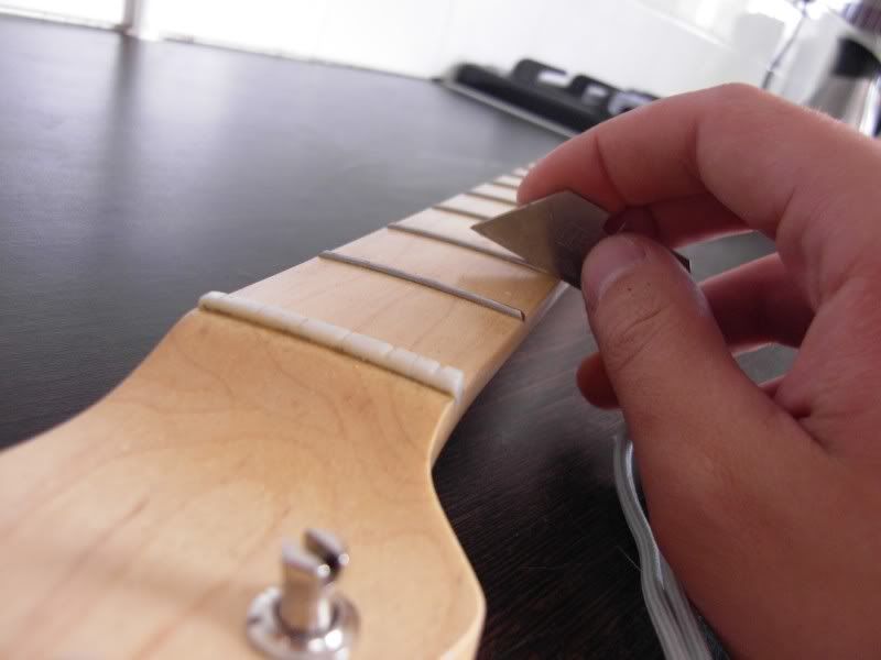

and ends at this angle (blade nearly flat on fretboard side):

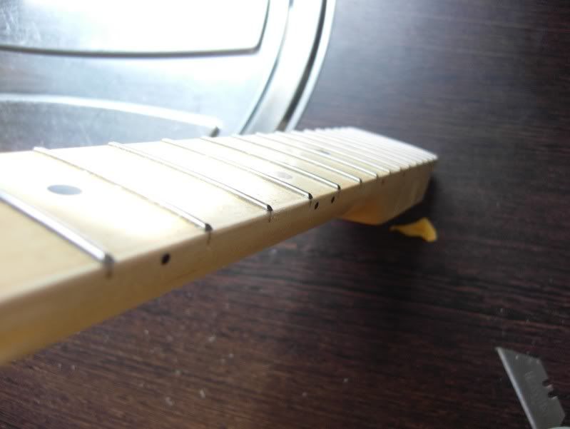

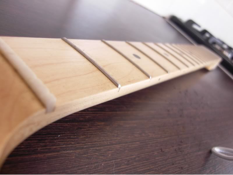

frets 1 and 2 done
and up to 11:

on this neck i am aiming for a consistent roundover so my strokes go in 1 direction only all the way from fret to fret.  i do switch directions to even it out but essentially its  done in full strokes.  If i was doing a relic or wanted it to look old rather than just be comfy i would be doing the strokes back and forth which would give a more scalloped feel to the roundover.

most importantly... i am not really pressing down, just lightly stroking the blade across the wood.  start light untill you develop a feel for how much pressue to apply
