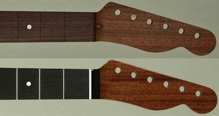

This is the sort of look I had in mind (but these are mahogany necks, of course).  More like the bottom one, but with the headstock trussrod adjustment.

actually i would just take the veneer right up to the sharp edge - no point making life difficult for yourself - but it could be worked into the curve if that line was important to you.

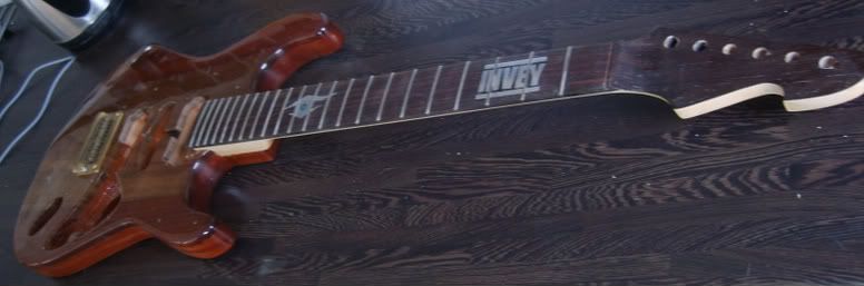

I have done it a few times with rosewood veneer on rosewood board necks and that ends up practically invisible
here is one i did for a local band which is actually a wenge veneer on rosewood neck but you get the idea
That was  a strange handmade strat copy with one of the worst necks ever so my job was just to build a replacement.  after that Ed had he singer paint the body and made himself a very industrial pickguard - and most importantly he put a warpig in it.  still playing through line 6 amps though which is a shame
