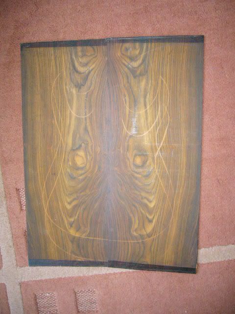

This is the top. This is the best pic of the top, rather. Its cocobolo. Its not the same as last time (that some of you may remember) as last times top suffered an unfortunate incident taking off the last 0.1mm needed in a thicknesser (due to its extremely intricate and unstable grain). Thats the truest colour pic that was possible - the reds and blacks in it are generally much closer to the fretboards colours, which were taken in spring/early summer sunlight, as opposed to house lights. There are two outlines of the guitars shape that bob offered the choice of - I went with the higher one.

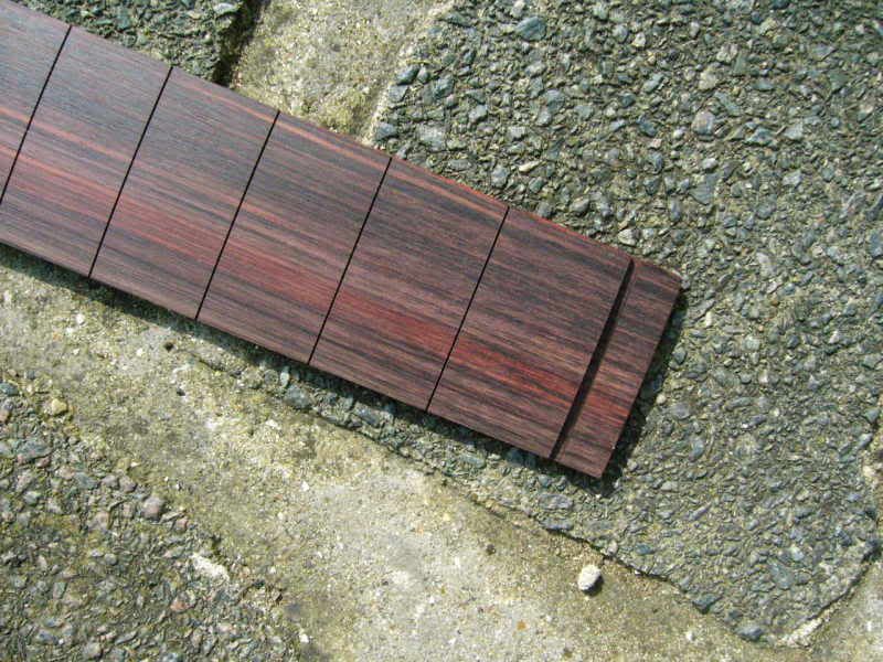

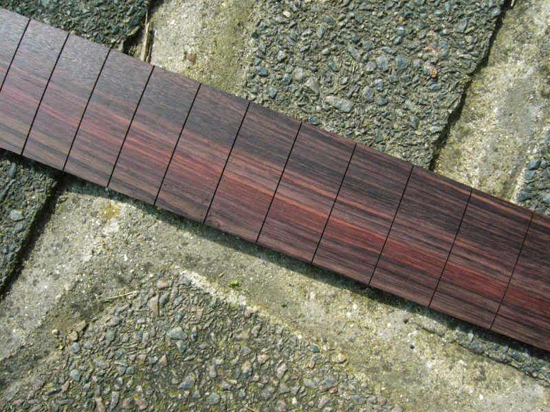

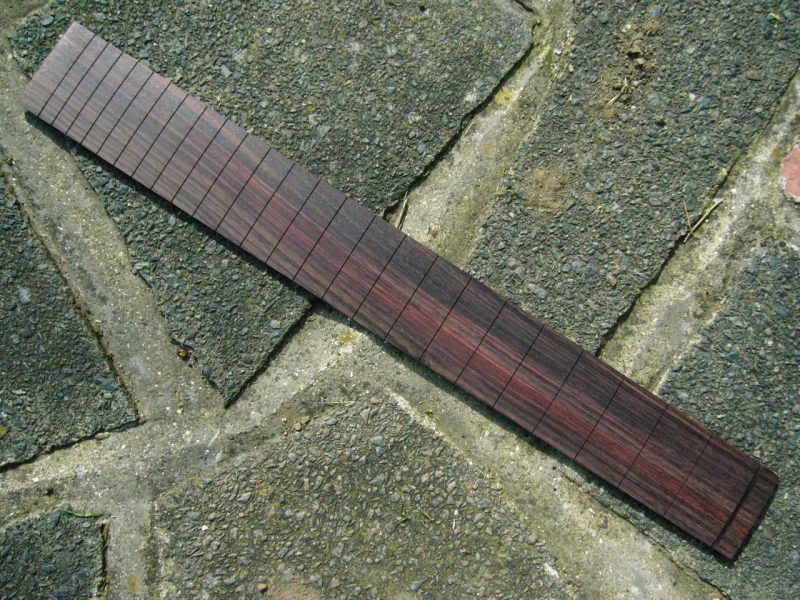

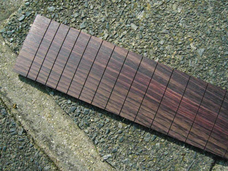

This is the fretboard. Its indian rosewood.

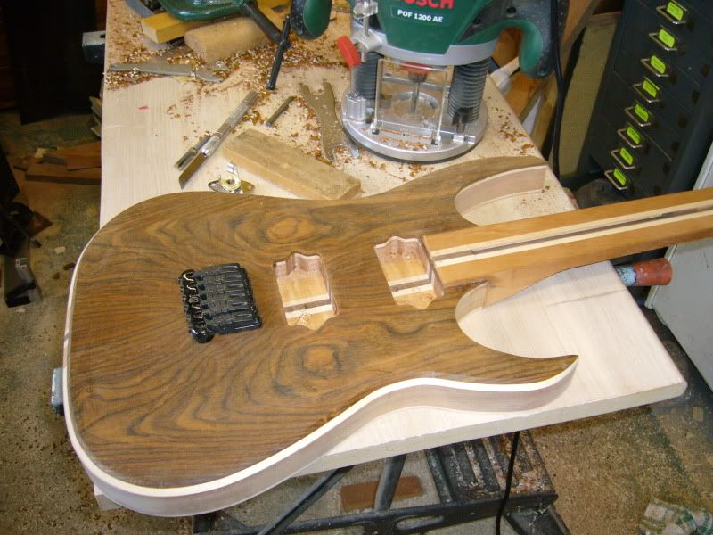

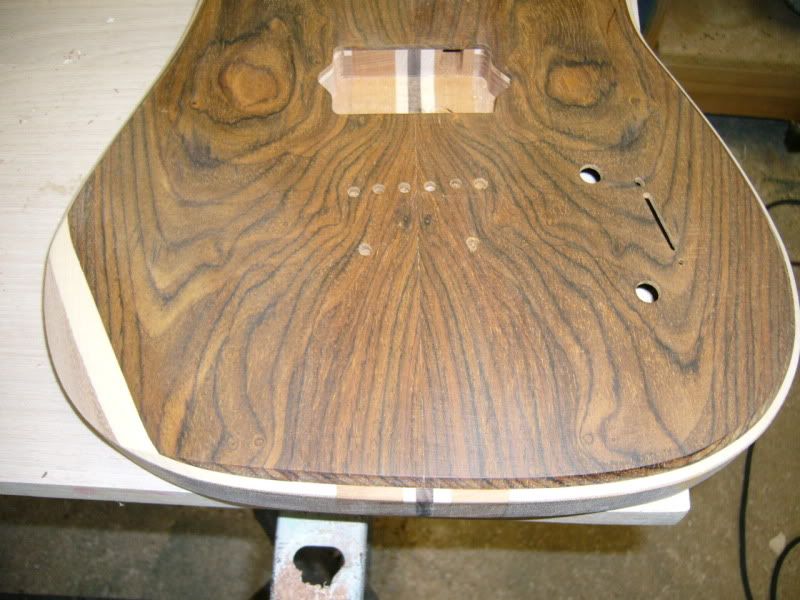

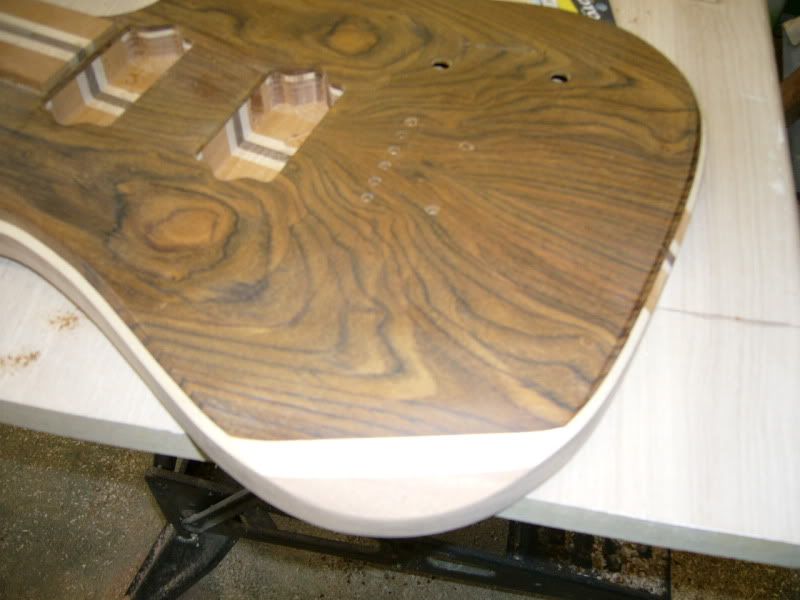

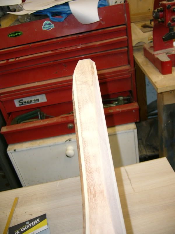

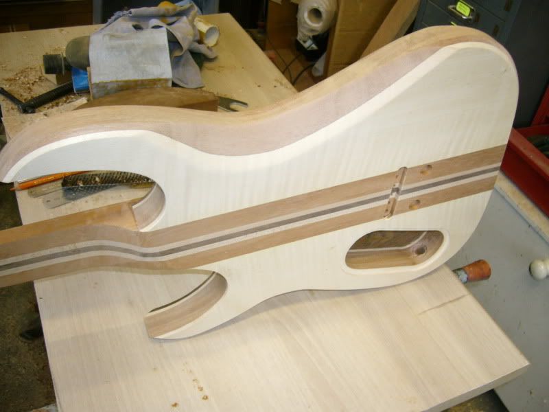

The guitar, with edge bevels revealing its layering, forearm contour and gutcut done.
There will be no heel on this - imagine a continuous curve between the inner sides of the horns, joining them up; the  neck will only reach the thickness of the body at that line.
Quite beautiful work, imo! Bob and I spent ages coming up with this design and its fantastic to see it take shape as envisioned.
Bear in mind when/if picturing the finished guitar, this is all bone dry, freshly cut wood, and the final guitar will be oiled, so all colours a lot deeper and much more defintion in the features in the grain.

i like a lot - personally i think i would have gone for cocobolo on the back too to tie it in visually with the front...  oh, and i probably would have put a black veneer between the DRM and maple layers for some contrast. but thats just the way i like doing it when i go for multilam thru-necks and bodies - just visual touches really

I considered veneers seperating the layers to give a line to them, but I decided that it would look too busy. I like it like this. I wanted the back to contrast with the front too!
