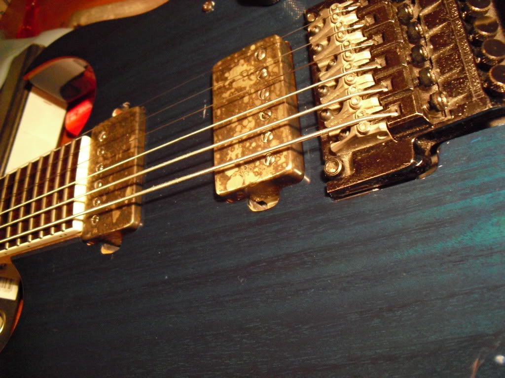

Hey thx Tim, but i already build in a Megaswitch E  :) I really like the sound of bridge + neck pickup split.
But I got another concern which doesn't relate to the topic but atleast to my guitar ;) *annoymodeon*
It seems that the BKPs are much thicker than the stock ibanez ones. Also the screws of the screw coil are much longer. Because of that i can't get the Pickups deep enough.
Here's a picture:
As you can see the pickups are as the same height as the tremolo.
I couldn't use the screws with the springs because of that too. I had to use the old screws of the stock pickups. I feel a little bit like Frankenstein who builds his monster out of different stuff.
Is there any way to get them in the right height without digging depper holes in the wood or playing with an enormous gap between strings and fretboard?

I managed to replace the stock IBZ PU in my RG 1527 with a 7-string Painkiller, but I have the same problem with the height.
I guess there is no way around drilling deeper holes. Hopefully I'll find time to do that next week and report.

« Reply #6 on: February 12, 2010, 06:30:58 PM »
hi,
damn you mr.ibanez (the real one ;)) for designing such inflexible guitars....

I already got the tools prepared, I just need to pass my exams next week (damn you English linguistics!) and I'll get started.
