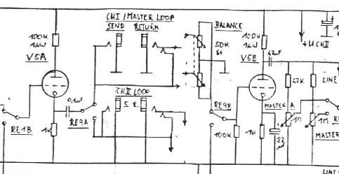

Interestingly I stumbled upon a couple of schematic diagrams for the Savage & both seem to imply that V5 does have something to do with the FX loop.  But the Savage has two FX loops (though only one of them is active at any one time - you can make loop 1 a "master" loop which deactivates loop 2, or have one loop for each main channel) - does this bit of diagram make any sense?  Are they basically saying that V5 is acting as a driver for whicever FX loop is switched in?
If V5 is the loop driver, are there any valves that are known to be particularly good in this position? Worth paying extra for "balanced" valves like for the PI?  If not, I may as well just leave it stock...

V5 is indeed driving the loop.
what you put in there probably depends on what effects you use in the loop, if any at all.
I use JJ ECC83's as a good standard tube. I wouldnt worry if i used one in a loop since i don't really use fx loops.
I can tell you V5 is the driver. But i have no real experience with playing with FX loops related tubes.

Excellent, thanks for the advice everyone.  Think I'll leave the PI & FX buffer stock & experiment with the first 4 valves.  A 5751 in V1 seems to be a popular choice for both Savage & Powerball so I may give it a go - it would have to take a LOT of gain away before I didn't have enough on tap.
I have just two more questions.
Looking at either of the following 2 schematics, can anyone tell me what V3 is doing?  I'm guessing that given the position of 3A that it's some sort of eq buffer (like that thing the 5150 has, forget its proper name...) or is it more gain stages like 1/2/4?
& finally (& this is such a dumb question that I chickened out of asking it in the first post :lol:)  I read somewhere that handling a valve with bare hands shortens its life.  Really??  I may have failed chemistry O-level but I'm fairly sure sweat doesn't corrode glass.  Surely as long as I don't eat a bag of chips & some spare ribs before I change my valves & my hands are dry, it won't be a big deal?

V3a and V3b in the Engl schematic above are just plain old gain stages - the first half drives the EQ from the plate (not the cathode like most Marshalls) and the second half is another gain stage.
