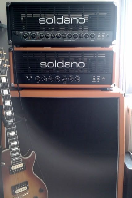

So today I swapped my Uberschall for a Decatone.
I got the Uber because I wanted some flexibility with my live sound. More flexibility than the Avenger could give me.
I liked the Uber but never fully got on with it. Always prefered my Avenger.
This is partly the reason I built my own 2 channel SLO-ish beast. That amp has something up with it (hum) and currently, Frank JPF is taking a look.
I didn't really want to get more amps, well, technically I have the same amount of amps as I did before!
These two will be getting used at my bands final show, unless Frank fixes my clone by then... may 29th!
Obviously this fella needs recovering Orange. I already spoke to Paul @ Zilla about that. I also swapped the grills for some spare avenger grills I had. So eventually I should have matching headshells for the Avenger and the Deca.
Now my first thoughts are EL34 conversion and FX Loop bypass switch.
Detailed tone report later I guess...

Did some A/B'ing just before work between the Avenger and the Decatone.
The Avenger has a bit more low end and punch. just a touch. The Deca has a bit more sizzle depending on where you sit the Master Volume.
They are very similar, I prefer the Avenger for the higher gain stuff but the difference is subtle so I can't complain.
Remeber the Avenger has EL34's and the Decatone has 5881's.
I'm wondering if this subtle difference is down to the valves.
I have been trying to get some information together to get this amp running EL34, but im slightly tempted to try KT66. I've never used KT66 before though. maybe i'd use them a bit and then still want to try EL34. hmmm.
EL34 vs KT66 anyone?
