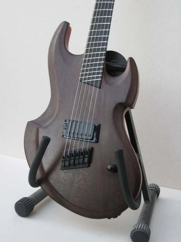

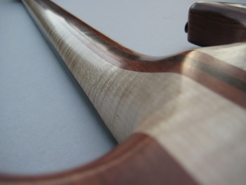

Just wet-sanded danish oil on imbuya
and wenge
danish Oil & wax:
tru-oil:
stain + oil & wax
