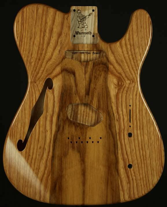

I have a Tele body which I was going to put a scratchplate on, but I like the weird grain patterns too much to hide them.
I've been thinking of putting a P-90 in, but I'm afraid to rout it myself i case I mess it up, should've got Warmoth to do it.  I might just go for a direct-mounted Tele neck pickup.
(Sorry, totally off topic thread hijack.  I just like this picture.  :lol: )

No worries re hijacking, PQ.
There should be plenty of room for that pickup config with a standard tele body, shouldn't there?
A standard top-routed body? Yeah, but not if you want the Strat control configuration.... unless you get a control plate with a third hole, but that's a bit cramped.   Or you could make a BIG scratchplate, like Thompson's guitar (or like a '70s Tele Deluxe), to hide the "hotdog" shaped control cavity.
