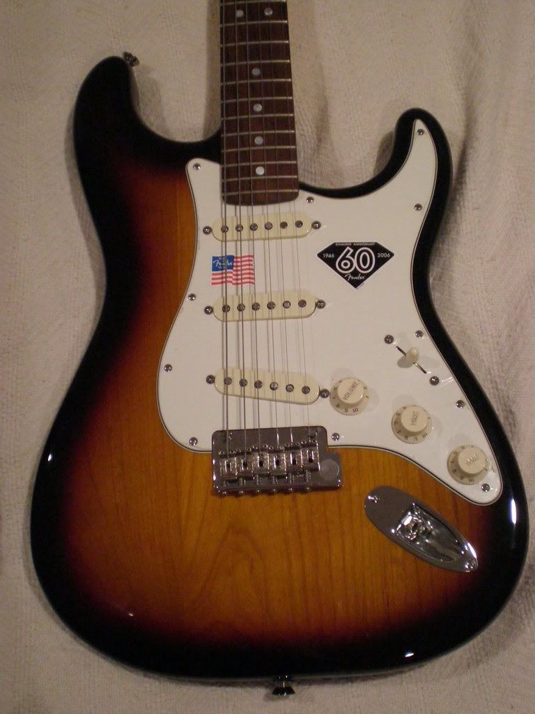

Here's a nice USA picture that someone posted and I copied to my photobucket.
It's got the USA bridge on it, the vintage-y radius and fret wire.
BUT - look at the string spacing and how the strings align at the top.
Just enough on the bass side, just like the Road Worns.... HOWEVER -
The important thing is that there is tons of room on the treble side for vibrato etc, and there's no way you're going to accidentally pull off the neck!

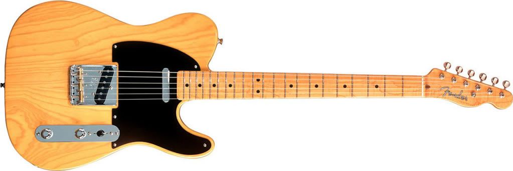

K - The vintage saddle Teles are 2-3/16" and the modern saddle are 2-1/8".
Not as huge as a difference as the Strats, but this follows what I felt when playing them, "...the Strats I've seen are worse than the Teles..."
I've copied two pictures from the Fender website so you can see what I'm talking about.
So I stand by my original assertion in saying that you can only improve a Road Worn by swapping pups and bridges, and that you shouldn't needlessly worry about depreciating the value as it is "only" an import model, not a Custom Shop or original vintage piece.
Look closely at where the high E aligns at the end of the fretboard.
« Last Edit: July 10, 2010, 07:15:17 PM by Copperhead »
