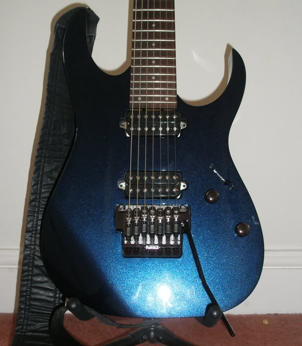

Snagged this really nice Ibanez RG1527 for a killer price a few weeks ago.  I've been really enjoying the one I bought from Kieran on this forum last month so I decided that this time, 7-strings were in my arsenal to stay & that I'd better get a spare one :)  This one is absolutely pristine, with the Royal Blue finish which is gorgeous - far better than any pics I've seen or my photographic skills can capture.
Anyway, after a bit of debate, I took it to Feline for the BKP treatment.
In the neck, my favourite VHII
In the bridge: AFTERMATH!! :twisted: - mega, mega thanks for Tim for winding me this & Jonathan for persuading him to :)
Best of all, we figured out how to get all positions of the Ibanez 5-way to work properly (I really wanted the neck parallel option in #4) - the answer is to get the magnets reversed on the neck pickup.
It's awesome.  I'm thrilled to bits. Between this & the HD-loaded black one, I can do all the low tuned metal brutality I need.  Very happy Antag :)

Yes - we finally got the RG 1527 wiring licked
We'd seen it often before and it requires a magnet flip in the neck pickup, but it was always a hassle getting all the combinations right.
Ibanez's own wiring diags didn't help much as it's not a direct translation to Bkp colour codes
