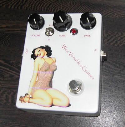

It arrived quickly with no customs charges so thats always good.  No instructions though.  there are clear pictures and a schematic on the website so its not too hard to figure out but its not the byoc painting by numbers approach.
By the time i had wired it up i was getting pretty fed up with the wire they had supplied, being quite prone to stray 'hairs' - but it all went together well and sounds pretty good, better than it should at this price.
One problem though, they say is can be a TS-9 or TS-808 clone but i really dont know which i ended up with, there were parts for both, but only one circuit diagram to follow and it didnt have a title!
anyway - decided to have some fun with decals as well - makes me realise i need a better printer so i may redo the pin-up at some point (have not sprayed over it yet)

Well done Wez - I've stuck to the BYOC stuff so far
I'm a bit worried about the angle of the girls head - think there may be a broken neck involved

This picture on the pedal suits rockabilly...  :lol:
