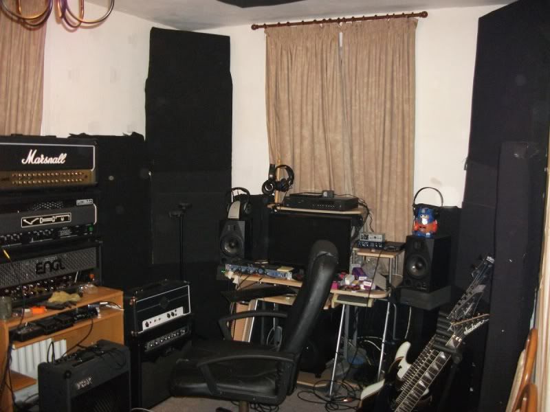

new acoustic treatment day
This is my studio.
Its made of gaffa tape, and black.
Seriously though...

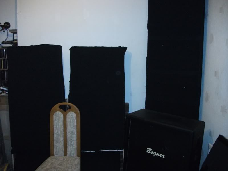

The traps are all rockwool; 140kg/m^3, 10cm thick in the corners for the lowest of the lows, the rest are 60kg/m^3 ~10 cm off the wall at main reflection and nodal points. Also, there are angled slabs of the same under them to catch some of the wall-corner build up. The entire wall area behind the desk and the monitors has a layer of rockwool (right up against the wall in this case) for the length-wise modes and early reflections off the monitors.
The sound in here is much more linear and much, much more resolved and clear now. Love it. Pretty cheap too. Seriously improved sound out of the amps as well; far tighter and, somewhat uexpectedly, livelier.

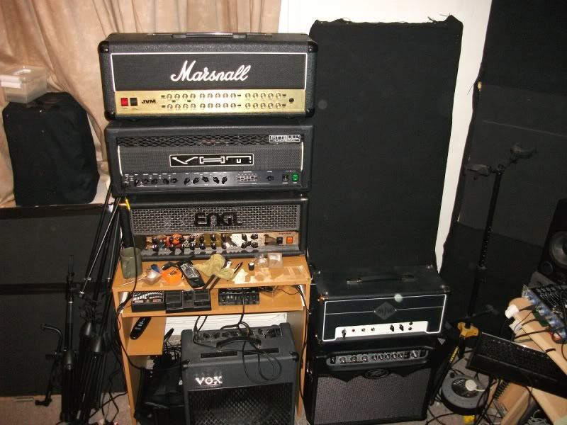

My amps

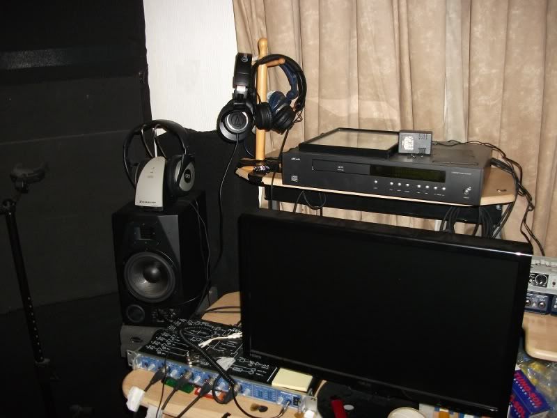

Some of my gizmos and headphones. Fireface 800, radial phazer, J48 and X-Amp, little labs red eye just off to the side, Phones; senn HD25 and RS140, AT ATH-M50, Ultrasone Pro750, and dont underestimate the 24" monitor for dealing with the information density in a DAW. I wish I had two. Adam A7s and a sub 8 (under the desk...yes ben I know you arent supposed to put them there, but thats where it works best in here).

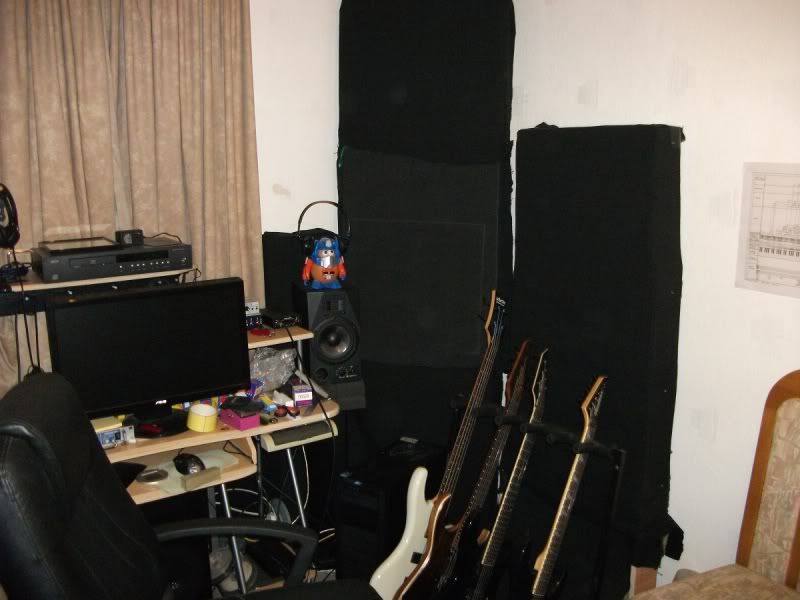

Some guitars. And Optimash Prime, in his continual state of thumbs-up approval.
Rear wall trapping, Ubercab, with V30s and Swamp thangs, on an Auralex Gramma.

Really, really struggling for space in here, actually. The size makes the acoustics worse too (4m x 2.7m x 2.5m ewww, all of which have a mode at about 120hz, so I get HUGE buildup there, which this and speaker placement have only just and so leveled out) with brick walls (very reflective).

The voxengo plugs are great, got a few myself. I work atm as a class assistant teaching Mastering and I've found Elephant to be a much better limiter than things that are up to ten times the price like the overrated piece of jobby that is the waves L2.
I think the reason that it might seem somewhat livelier though it might seem like inverted logic is that your losing the build of early reflections in a small space that cause a blur so it's easier to hear the depth of the space the instruments are recorded in.

Apart from the obvious sub problem you might want to move the screen back a little, kinda messes up the stereo imaging.

Trust me, the sub is where it is for a very good reason - the seperation between the monitors and sub is part of how I'm dealing with my gargantuan ~120hz buildup. It can go in a corner, but i found it has an adverse effect on the stereo field at the crossover I require (a little too high to be non-directional). I may experiment again, now that I have better treatment, however.
Accepted on the monitor (visual) location, I realise that, its only where it is because I had to dig around in the cabling thats behind it.
