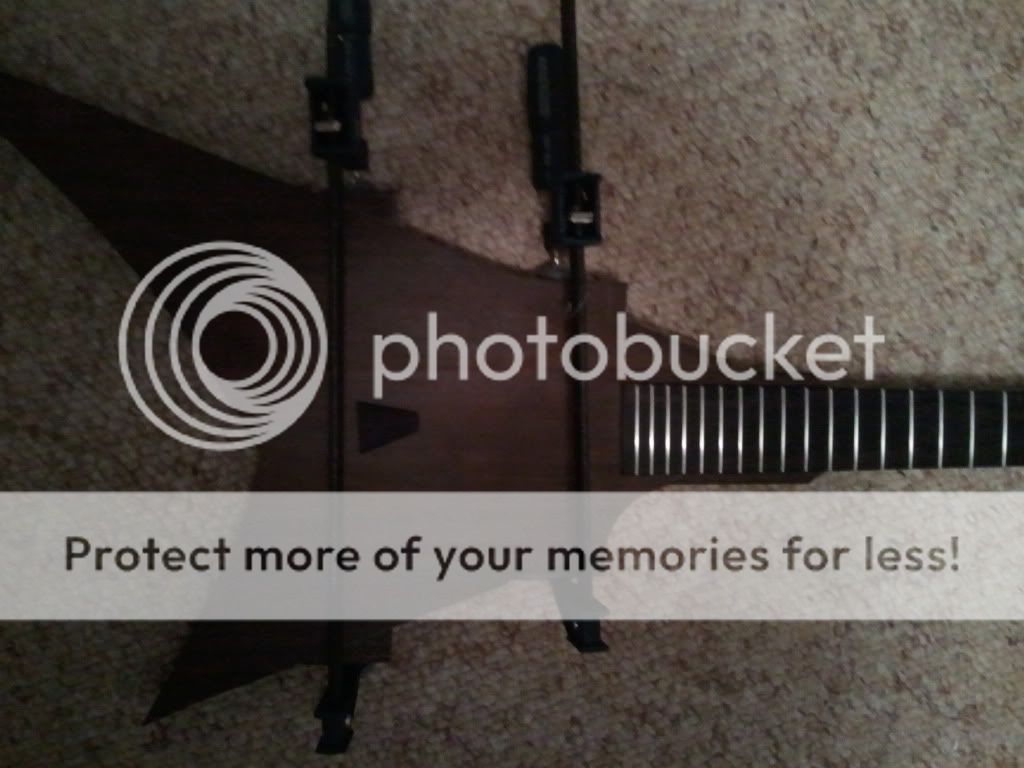

« Reply #16 on: December 17, 2010, 12:13:13 AM »
Starting to take shape. Here's a pic of it still clamped up. I wanted to show how I had to put some steps for the clamps to pull in squarely. Those got nipped off with the band saw. The little blackish triangular piece there is my truss rod cover. I had to keep my hands busy for awhile after to keep them off the curing piece. It's wenge, made from scr@p that came off when I ripped the original piece of timber. I put Tru-oil on it, so there's the difference between the body color now and later when it's wearing a bit of protection. I did have a slight shift after gluing the longer wing on, it was about a piece of paper's thickness, but it's standing out in this photo though it's been sanded now. Next pic update will be right before I start routing things, so after the neck heel is carved, the bevels routed and a good bit of sanding done. I'm gonna have to research how to take better pics, mine kinda suck, lol.
