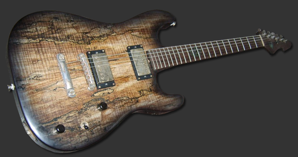

The final thing I'd bear in mind is, that spalted top may just be killing the guitar, or exacerbating the problem. Its very pretty, but its an acoustic nightmare. All the little black lines are breaks in the woods grain caused by fungal infection of the wood, and the wood has basically no structural strength, its just mush, and mush is what it can do to a guitars sound. If the top is more than a veneer then it *might* be the problem (or adding to it).
I mentioned that earlier - but i dont think its much more than a veneer on this.
how they managed to cut it into a veneer i dont know - i imagine it was stabilised first.
Spalted maple can be fine - but i generally dont trust it being used on factory guitars - when i use it myself i have spent weeks stabilising it properly .  definately not a wood to use in any kind of thickness - especially the cheap examples most factories are using.  that veneer on the guitar above is very low grade - hardly worth bothering with, and that seems to be the case with a lot of spalt i see being used
sometimes it looks so good its worth the extra effort
even so i have never used it over 5mm thick and always with the bridge mounted firmly to the wood underneath.
