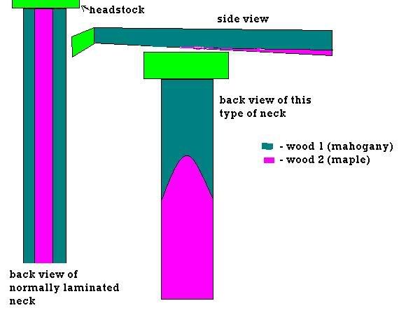

oh - i am also curious what is unusual about the neck-through construction?

And for the final question, it's kinda tough to explain but here's a diagram kind of detailing it...
http://i113.photobucket.com/albums/n216/salsawords/necklam-1.jpg

the neck construction is interesting - i generally dont like quilted wood in necks because quilt is less stable than the equivalent straight grained wood - but pairing it with the mahogany as the main neck wood should solve that
Yep, that was my exact thinking.
