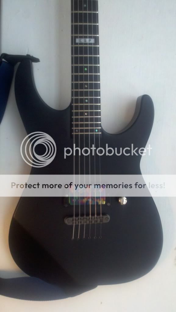

Thick, articulate, and smooth is definitely how I would describe my A-pig. Also, I have it in my esp which is maple neck-thru with alder wings. I'm not the foremost tone expert on this site, but this is the one recommendation I'm qualified to make. Just buy it already!
It's got a switchcraft 500k DPTP, and I wired it for series/parallel. I can go from thick and full to Racer-X by pulling up on the volume. Also, the burnt chrome really meshes with the abalone inlays, but that's just a side note.
