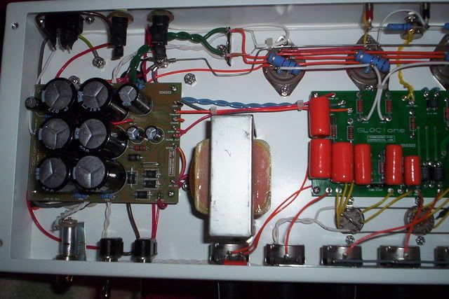

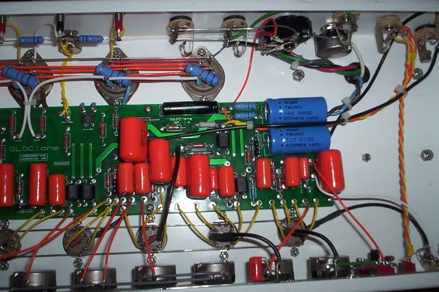

It's covered. Its orange with chrome corners and black grills. The only thing it doesn't have any more are feet and chassis bolts, I used them for something else.
I built the amp really well. Problem solving it got to the point where I'd have to rebuild the all the PCB's or order the transformers again, and It would have just cost too much at the time. I had great help trying to find out what was wrong. If I built another I'm sure it would work fine, I'd use the C3 boards rather than the Smash ones though.

I did use the O'netics.
I even emailed Bud Purvine about the problem I had. He suggested it might be leaking EMI from the PT and gave me a test to do involving a true RMS meter and some coiled wire. It didn't really find anything. He was going to ask Mike Fortin I think if he had any advice.
He did tell me the O'netics are over spec'd enough so that if you melted your output valves both transformers should still work fine.
I think I just had some bad luck with it.
My amp is mostly scr@pped. The chassis now has more bits of powder coat scr@pped off because I worked through the whole noise reduction thread on the sloclone forums, which mostly involves altering the grounding scheme (that isn't on the pcb). The sockets have been used in other things, so have the pots, jacks. All that is left is the choke, and the power and preamp PCB. I could write a book based on all the tests I did to it. I think I just had some bad luck though.
Plus, If I did build another from scratch, I would still have paid less than getting a real SLO, and I wouldn't have had to get it via sound control, who I refuse to do get anything from. Since they are the only soldano importers in the UK that pretty much means I won't be getting another soldano product any time soon. So, I don't feel that bad about it. Great learning curve, and It's led to me building other things (that totally work).

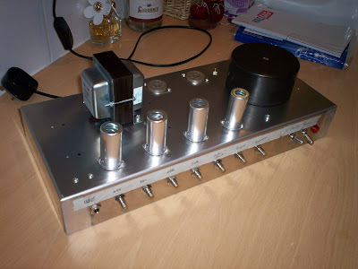

« Reply #12 on: March 03, 2011, 03:05:32 PM »
The first of many packages has finally arrived. :D

nice.
when I got mine bits they came with the transformers and 3 of the mains filter caps had huge dents in them. glad you've avoided that!

Yet yeah  noticed that on the blog I got all of this quite cheap from someone on the slo clone forum. The transformers etc should be on there way son hopefully
