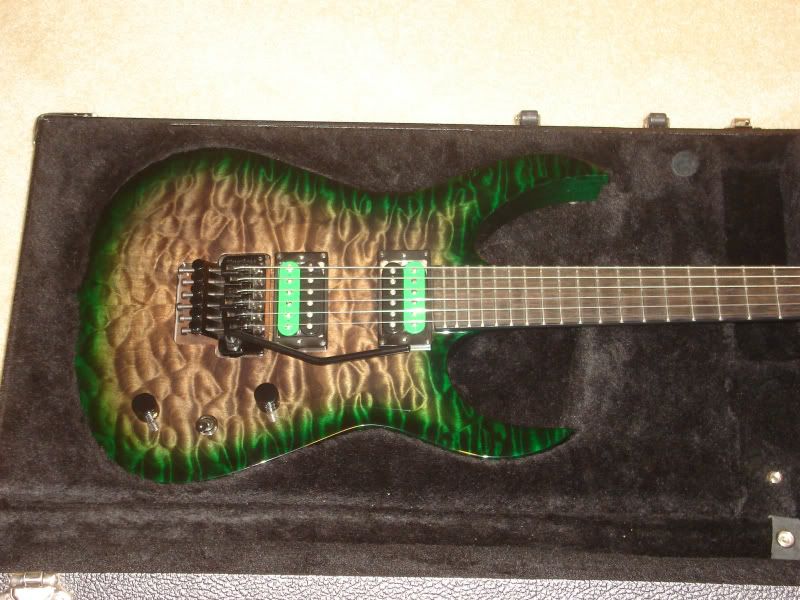

Hello all. First time post, long time user. I recently bought a guitar off ebay, and the origonal owner had changed out the EMG's for a Painkiller set. So I got the guitar, and noticed that it sounded really dark. I like a guitar that I don't have to try and dial highs out of and is balanced, so I sort of liked it, but thought it needed a little more highs. It sort of sounds like the tone control is dialed back a bit.

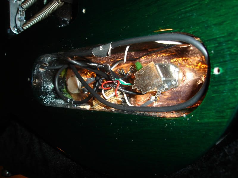

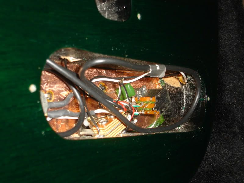

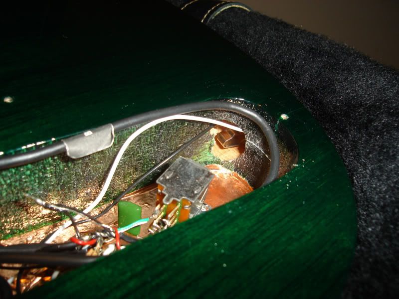

So I took a look inside to see what pots were in it, and found that the volume pot is a 25k. I got a reading of 250k off of the push/pull tone pot. I got a reading of about 180 - 185k from the jack to ground. So I guess my question is, if I want to add some highs/bite to my tone and let it breath a bit, should I go with a 250k volume pot? 300k? I hate bright, and have heard the Painkillers are rather brite and midrangy, so I'm not sure if I should go with a 500k even though it's most common.
I appriciate any advice you guys can give me. Here are some pics.

Oo, that's one nice lookin' axe. What brand is it?
SrDeMaFp
  • Posts: 30
Re: 25k pot with Painkillers!?! WTF?
« Reply #11 on: August 03, 2011, 03:09:23 AM »
Looks like a Bernie Rico Jr Hesperian(?) And a DAMN nice one at that!
