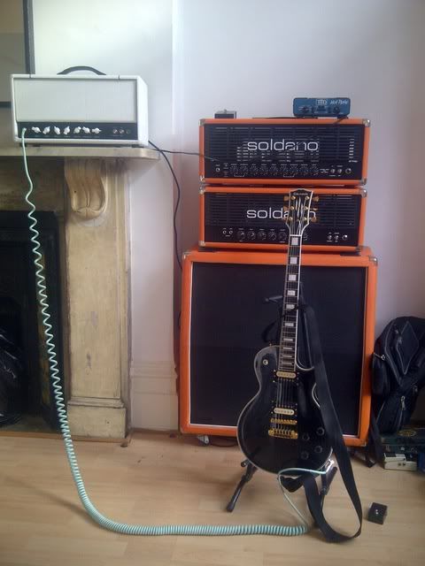

So this is my latest build.
http://www.youtube.com/watch?v=AYaiyqxas8k
I'm playing (or attempting to play) my Edwards Les Paul with Nailbombs into it.

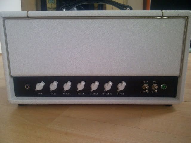

Its a JCM800 circuit with a Depth control. Basically this thing is pretty much a 50watt EL34 'crunch channel only' SLO100. The power supply/filtering is different though.

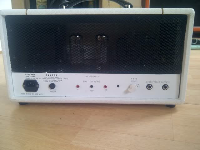

It's got the usual controls you'd find one something like this, plus bias test points at the back and a precision pot with a locking wheel for you to set the bias with opening the amp or needing a screwdriver.
I'm tempted to do 1 or 2 more tiny tweaks to it, but I'd say this is 99.9% done.
I suck a doing clips. The clip above has lots of photos.

Nice!!! Need some gut shots though :-) Where did you get the faceplates from or did you make them as well ? Gotta love DIY amps.... The fear adds a little frisson to the first chord :-)
  • Posts: 3577
Re: NDIYAD - New DIY Amp Day
« Reply #11 on: September 10, 2011, 10:26:40 AM »
The faceplates are from our own JPF Amps, who resides on this forum from time to time.
The chassis is actually his Mk1 chassis for his range, so his amps faceplates are the same dimensions as the ones on this amp.
The front was originally white but now its that white on black stuff that Hiwatt uses. Traffolyte.
