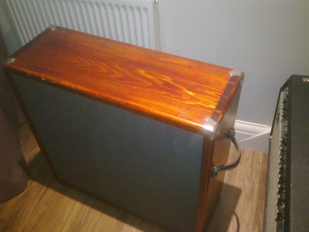

i built a solid pine 4x10 cab a few years ago and i can definately say that pine resonates alot better than your standard birch ply cab. i went to town on it a bit and dovetailed the corners, (just cause i could) not for any tonal reasons.
loaded it with jensen p10r's and voila, great sounding open back cab. i was using a matamp 4x12 which i sold as soon as i finished the pine cab. i would'nt claim to be any kind of expert on this as i've only built the one cab. but it does sound better than anything i've plugged into so far.
