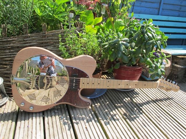

I have just bought in a Blue Note P90 which I have built into a Sollophonic guitar, and sounds very good. Something similar to this in fact.
