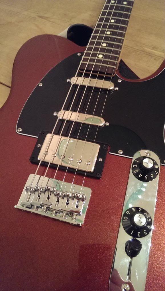

Here it  was stock:

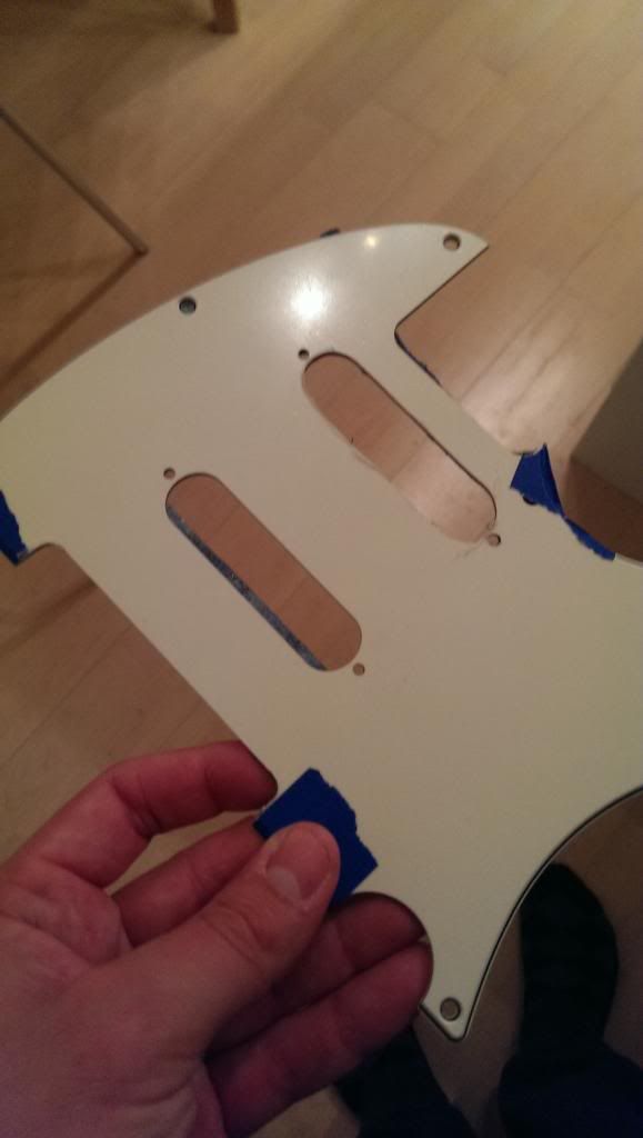

I got myself a Nashville Tele guard. I bought a standard sized HSS set which meant I had to enlarge the neck pup hole for a strat sized pup.

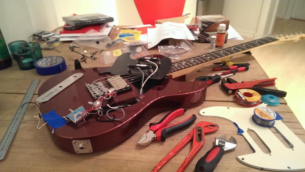

Spill its guts!

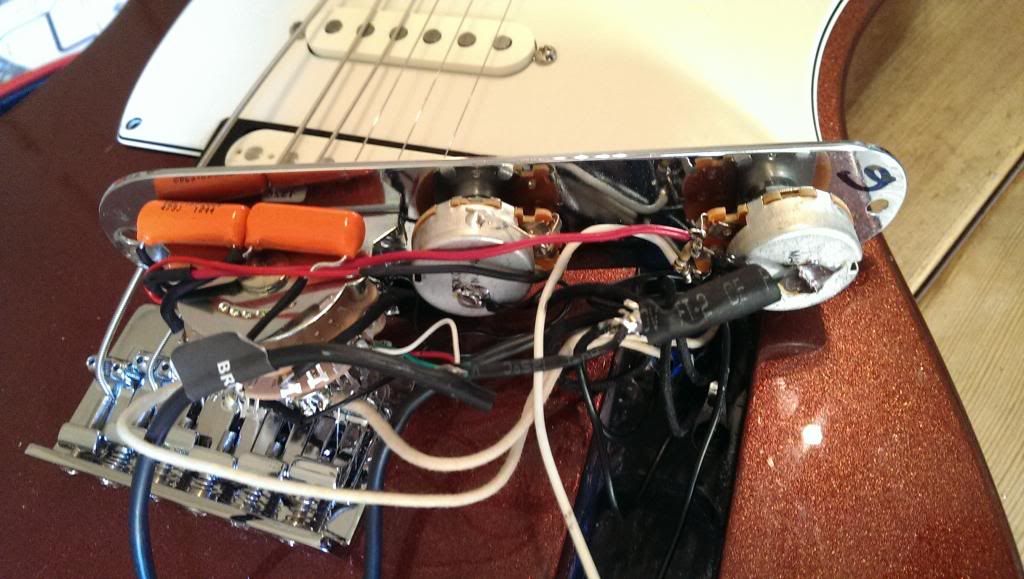

I was kind of ambitious, tried the Suhr wiring that puts some resistors and caps so the singles only see 250k. Clever, but it didn't fit the cavity with the superswitch etc. 4 hours wasted  :rolleyes:
I simplified it in the end running two 470k resistors parallel for the single coils, works very very well. Also install a high pass filter/treble bleed mod.

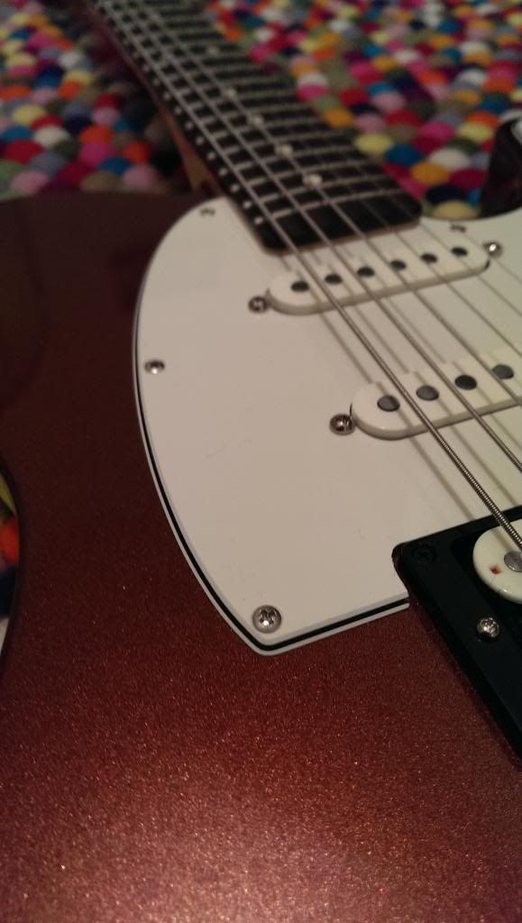

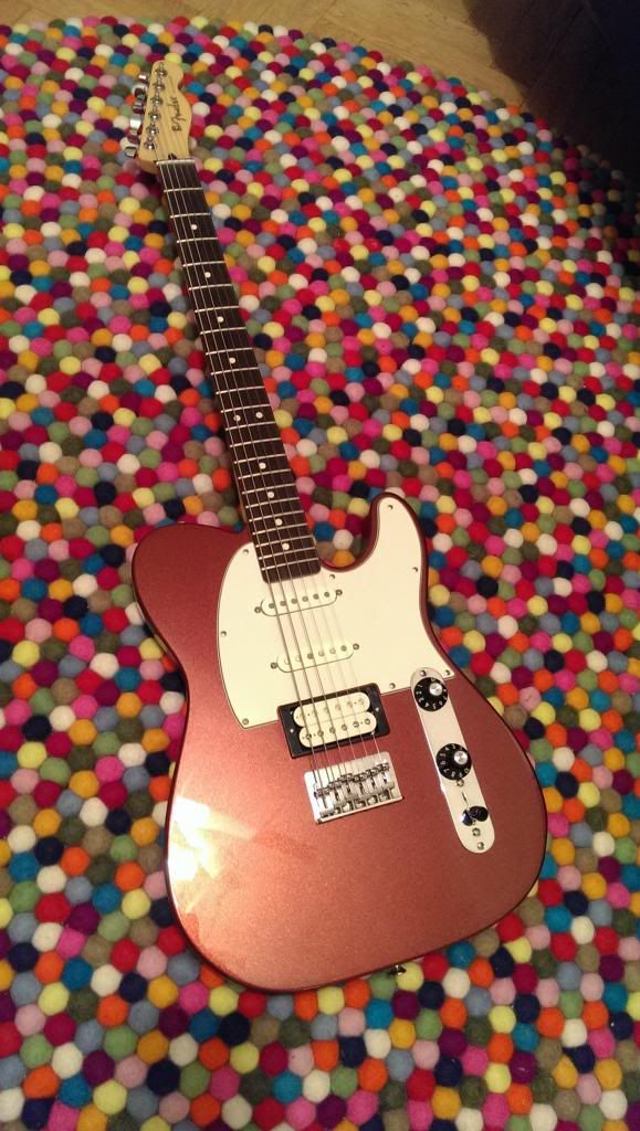

And here is how it turned out:
It's difficult to capture the colour, but the orange is really nice. Especially now with the parchment pickguard.
Man, there pups sound so good. I must say that BKP makes some incredible stuff. The pups really made this guitar come alive, I can't believe the difference. Normally when I change pickups I notice a slight difference, and you learn to play it. So after a while it's really obvious. But compared to the stock Fender pups, it was like night and day. Never experienced it like that before. The cool thing is that the split sounds still sounds like split sounds even running full gain. Often they just get muddied up, but these pups still retain all the clarity and definition (I do think the resistors helped here too). It's cool to be able to switch and hear a difference.
