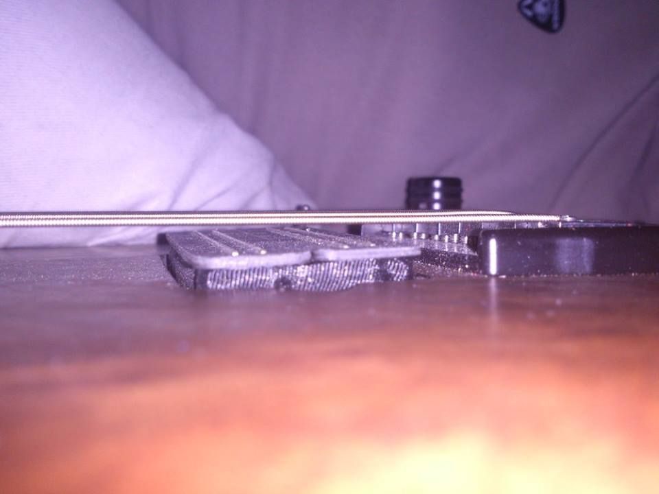

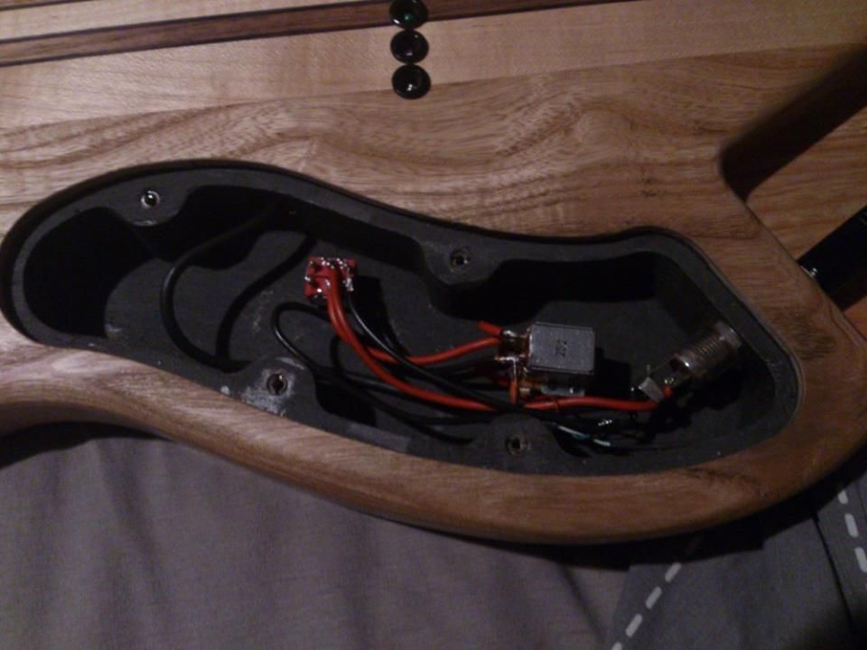

Im posting this on behalf of a friend. He has recently acquired a second hand guitar with a BH pickup in it. However he seems to be getting a lot of feedback from it-this doesnt happen with any of his other guitars. The noise goes away when he rolls the volume down on the guitar or uses the killswitch. However it doesnt go while playing the guitar. Here are some pics of the electronics and the pickup height-what do you think is the most likely cause for this?

i can't make it out from the picture but is there a ground going from the bridge to the rest of the electronics? i can see one wire going to the pickup but not really any distinct ground.

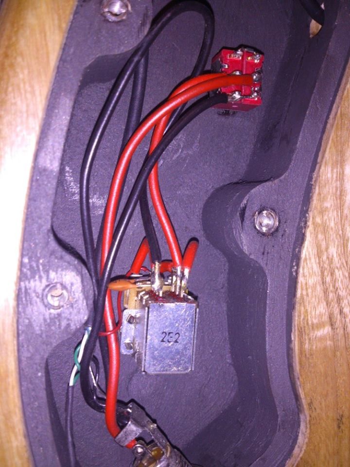

Cheers Keven - this may help?
I agree.  First thing I'd check out is that there is a functional ground wire running from the guitar's bridge to the electronics.  Second, verify that the cavity is coated with electrical shielding rather than just black paint.

I agree with above, doesn't look like the cavity is shielded unless that's some funky paint. I'd still get some copper shielding for it if it was.

if we are talking abot microphonic squeel feedback then only wax potting the pickup again will help
Try tapping the top of the pickup with a finger or pick - if you her it loud and clear then the pickup needs wax dipping
You can send it back to BKP or find a tech who offers the service (like us)
the black/grey paint is likely to be a carbon or nickel screening paint
is the guitar a Sabre? ( the recessed jack looks like one of their designs)

It's easy to test the shielding with a continuity check beeper on a multimeter.
Shielding paint comes in a couple of different colours.
I can't see a bridge ground wire in the photos.

Thanks a lot guys, i will feed all your input back. Seems that the obvious one is the ground wire? how does he go about fixing this? sorry, but im a complete noob when it comes to electronics also  :(
