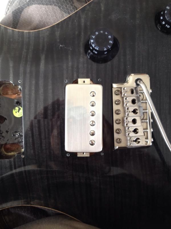

« Reply #4 on: March 09, 2014, 12:51:44 PM »
It's the legs, again me using wrong terminology. The pickups are short leg.
I've taken a picture to show the problem. Hopefully it shows up. But the pickup in the picture is resting on the body.

Re: Installation Help/Suggestions
« Reply #5 on: March 09, 2014, 01:11:25 PM »
It's not ideal but you can bend the legs in a bit.  As long as the pickup fits in the main rout, it will work fine.  The other thing ive done a couple of times is to snip the corner of the 'foot' off with a pair of wire cutters.  That gives you more clearance.  Did your guitar have covered pickups originally?   If it didn't, you might have more issues.

« Reply #6 on: March 09, 2014, 01:30:50 PM »
What are the actual pickup rings like?
If they are as large as Gibson pickup rings one would assume that you could rout the body slightly to enable the pickups to fit without any visible problems, but if they are smaller then I wouldn't take that option.
I guess you could grind the edges of the 'foot' down, but you would want someone who really knows what they are doing to do that because if you slip and scratch up the covers you won't be happy!

« Reply #7 on: March 09, 2014, 01:55:28 PM »
I've bent the feet back and they now seem to fit. Hopefully they will move freely and fit with the pickup rings still.
