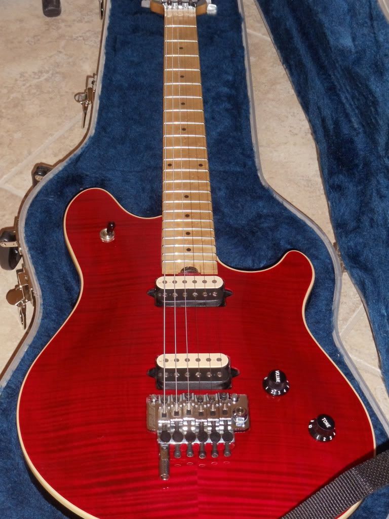

I ordered an open Juggernaut set in Zebra for my Peavey HP Special. This is how the guitar looks stock:
So now I realize the stock bridge is Zebra, the neck is reverse zebra.
Would it be a huge tonal difference if I had the neck installed upside down so that I could keep the original look?
Note that the pickups on this new Jugg set are all screws, as opposed to screws and pole pieces
I'll pick tone over cosmetics, so I'll put them in as designed if needed; it'll still still look fine and iI expect it will sound awesome
Thanks!

Re: Help needed: Jugg Zebra flip??
« Reply #8 on: January 06, 2015, 11:49:04 AM »
both pickups in that image are zebra.
screw coil = white

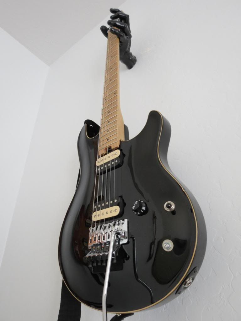

Oh cr@p, I can't get my head around the whole zebra confusion
Standard Wolfs look like this color scheme, screws on the bottom:
My black HP has screws on the outside, white on the outside (?)
The more I think about Zebra, the more it hurts....HP is ready and will be picked up today. My tech mentioned something about how flipping it would give a different split coil that will be different than the popular inside coil. No matter, I hardly split, and it may be cool anyway...tune in later to (hopefully) read about my Jugg HP glee!
« Reply #10 on: January 07, 2015, 09:05:35 AM »
The red guitar has two reverse-zebra pickups. screw coils=black.
if you have four conductor wiring you can split whichever coil you like, just need to wire it a different way. You won't notice too much of a difference either way to be honest.
my advice: be cool! i'm sure it will all come out looking and sounding just grand.
