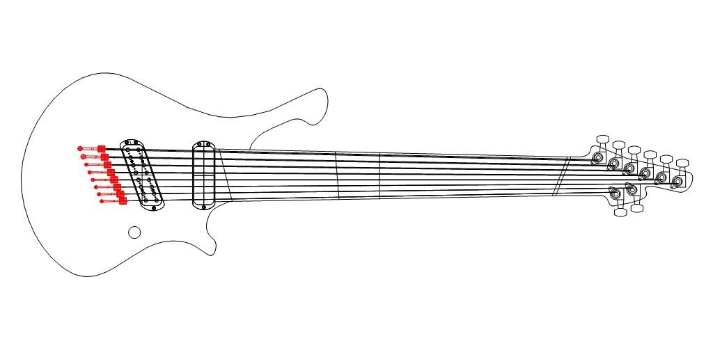

Most recent possible outline -  this is the 10th attempt  :lol:  the jpeg conversion is a bit rough for some reason

« Reply #12 on: May 23, 2005, 07:31:47 AM »
They look amazing-just don't ask me to play it,I have enough trouble with 6 strings :lol:

« Reply #13 on: May 23, 2005, 09:52:52 AM »
Any feedback on the design would be appreciated btw :drink:

« Reply #14 on: May 23, 2005, 11:09:50 AM »
Nice stuff! I like the upper horn of the 8-string, kinda like an inverted Iceman. BTW you must have BIG hands.
