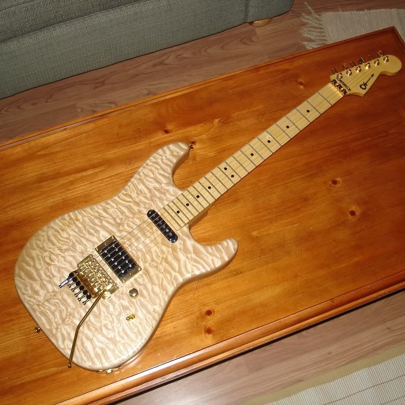

Hey guys,I'm new here and would like to get some advice.I have a killer playing Wayne Charvel parts guitar that needs a new bridge pickup.I play tunes from bands such as Ratt,Billy Idol,Maiden,old Priest,Thin Lizzy,Alice In Chains.It currently has a VH2 in it but for me it sounds a little too thin and bright,almost tele-ish.I need something a little warmer with higher output but still cuts through in a band situation.The body of the guitar is a Wayne body made of Alder with a beautiful quilt top and the neck is a Musikraft one piece rock maple made to Charvel specs.Here's a pic:

I have no idea on the pickup front, but that is one awesome guitar!
welcome to the forum! :D
sambo
holy mother of mothers......... thats the maddest quilt top ive ever seen...
...thats.... thats.... thats just crazy man...  :o
anyway yer, cant help with pickups sorry man...  :lol:
but that guitar  :o

Stunning guitar. I'm thinking something like the Crawler would deliver what you require.

is that a d-tuna you have in the floyd?

Quote from: Neemois that a d-tuna you have in the floyd?
Yes sir it is.It works awesome.I have a Performance Guitars Big Block on the Floyd too which increases sutain and tone unbelievably.Also I have KTS titanium blocks in the Floyd that hold the strings in.No more cracked blocks.

Great guitar - looks superb!

that guitar is hawt. could yu explain how the d-tuna works? i have one on my ibanez but it's built in with the ZR tremolo; my tech told me that mine works in a more accurate way than the EVH one, but im not really sure how?
