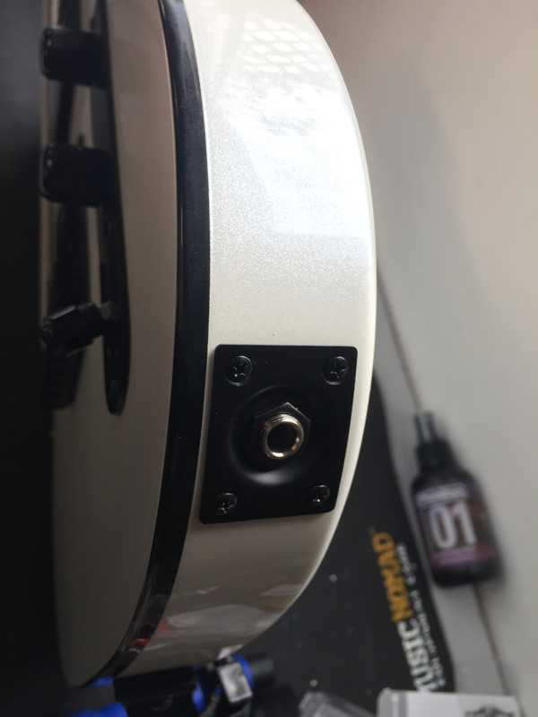

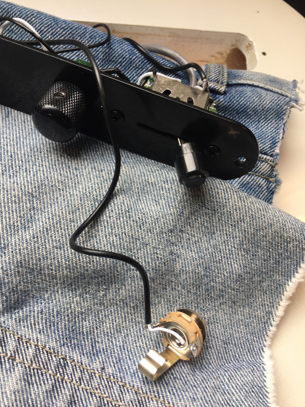

The other 'mod' was more a replacement for a terrible jack that couldn't wait as my cables kept falling out of the jack.  The stock jack is the usual Squier rubbish so I replaced it with a Switchcraft jack.  I will use this jack for a brand new harness after my Bare Knuckle order arrives.  I squashed the original so that I wouldn't be tempted to reuse it!  In this photo you can see the original control plate with the Gotoh VK-18 knobs, which will be transferred over to the new CRL, CTS, and Neuland loaded control plate when my order arrives.  I used the denim rag to protect the finish when soldering.
As you can see in this photo the Contemporary Telecaster RH has a jack plate, not the old school 'cup'

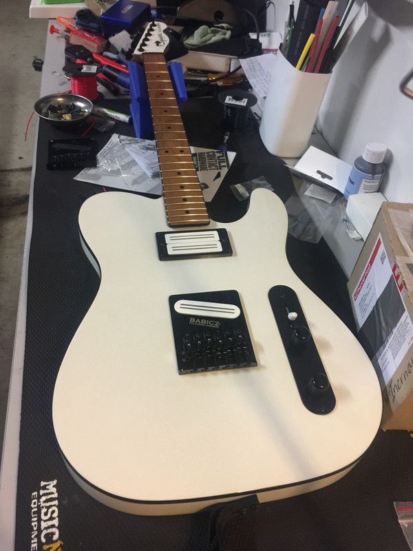

Here's a photo with the Babicz bridge test fitted:

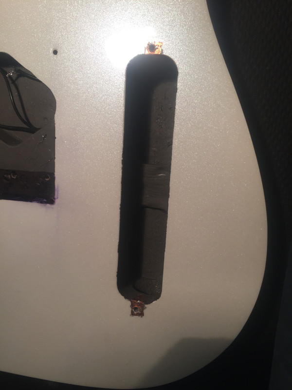

The cavities were not shielded:

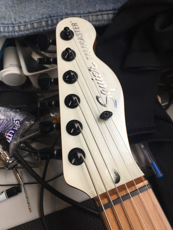

I had to take great care when drilling the roasted maple headstock to fit the screws for the Gotoh SG381-MGTB tuners:

The cavities were shielded with nickel conductive paint, and copper slug tape was fixed to the top pf the body under the bridge and control plate.  A new bridge ground wire was made and soldered to the copper tape:

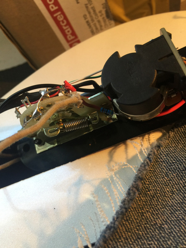

The wiring harness under the new Gotoh control plate:
The Babicz bridge installed.  String from the top with D'Addario EXL148 12-60 string set, with the 20P third swapped out for a 22W.

The truss rod recess has been painted black.  Note also that a Graph Tech Black TUSQ XL nut and string tree have been fitted:

The jack has been replaced with a Switchcraft, and a black washer and nut have been fitted (the jack plate is stock):

Okay after some experimentation with wiring and having some tone issues I decided that the best approach is to treat the Cobra-T the same way as a humbucker, and removed all of the weird wiring and wired it exactly the same as my PT Apocalypse with the calibrated Impulse set.
550K BKP CTS master volume pot with treble bleed kit
550K BKP CTS master tone pot with 0.022uF BKP Dueland PIO cap
3-way selector switch
No greasebucket mod, no coil splits
