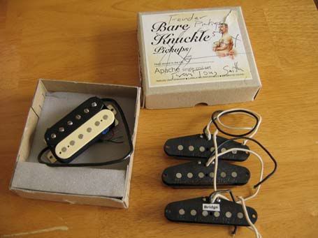

I've just bought some secondhand pickups with Bare Knuckle Pickups Stamped on them. Can any one help me identify what exactly they are?

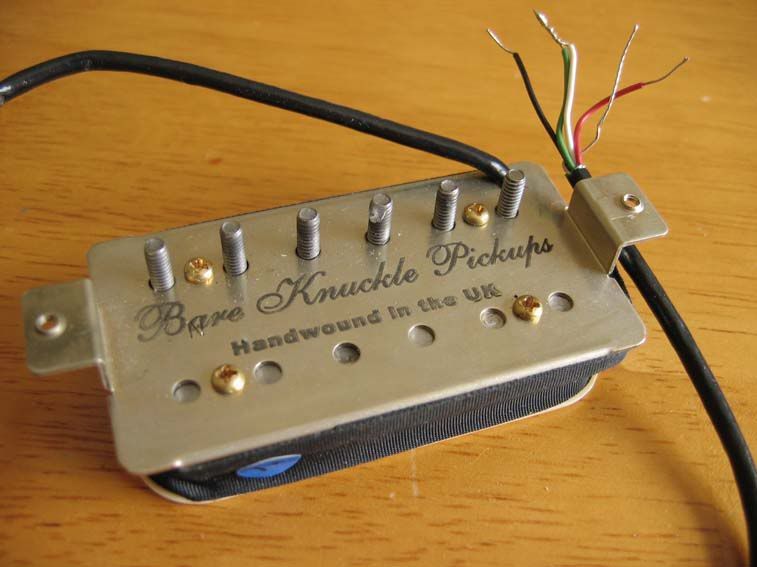

One is a Zebra Humbucker, with a N stamped into the base and 4 core conductor wire. The White and Green cores have been soldered together and give a resistance reading to the black wire of 4.39 Ohms. The resistance between the Black and Red wires is 8.12 Ohms.
The other is a full set of Strat Single Coils. They've come in an Apache Set Box. They all have the same magnetic polarity. One has a sticker with "Bridge" on it and reads 6.82Ohms the Other two give readings of 6.13 and 6.11 Ohms. Am I right in thinking the lowest resistance reading would be the neck pickup. There are no blue or Red Dot Stickers on the base but they are  embossed with the Bare Knuckle Pickups logo, just like to top of this page. Are these Apaches ??
Thanks in advance
Chris

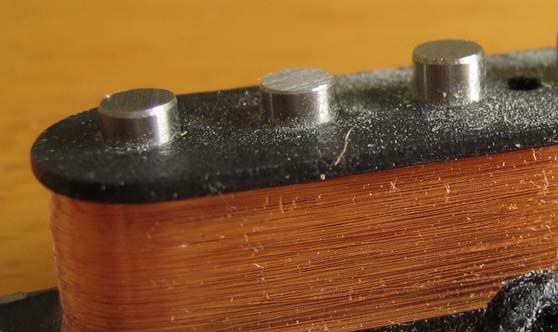

If I could find out what type of magnet is on the pole pieces I could confirm which set these are supposed to be.
These are the pickups
Top of Humbucker
Base of Humbucker
Strat Pickups
Is this hand beveling on the pole pieces ??

Well research tells me that the Humbucker is either a Mule or a Riff-Raff
Does anyone know how to finally confirm the difference between a Riff-Raff and a Mule ?  :)
Help to Identify Pickups
« Reply #6 on: June 21, 2006, 04:42:41 PM »
I guess the DC resistance makes it closer to a Riff Raff, but it's close to both.  Have you given Tim a ring directly and asked him?  Surely he'd know how to tell them apart?

Humbucker could also be a VH2 neck pickup.

The humbucker is going in a Tokai Love Rock II as that already has the coil taping switches present and the existing gotoh pickups aren't scatterwound. However I would like it to match the other pickup which has a nickel cover.
How do I go about putting a cover on it ?
If I put a cover on it, would it need wax potting again ?
Cheers
Chris

Send it to Tim, He'll put a cover on for you without invalidating the warranty...He could probably tell you what model it is as well :P

Wire looks a lot like Heavy Formvar , so those singles look like Apaches to me.
Apache,VHII,Emerald,Nailbomb,MiracleMan,StormyMonday,BlackDog,Trilogy,Mothersmilk,Sultans+Sinner
chrisheyes
  • Posts: 93
« Reply #12 on: June 22, 2006, 09:22:02 AM »
Thanks for the confirmation HJM, that's  music to my ears  :D
