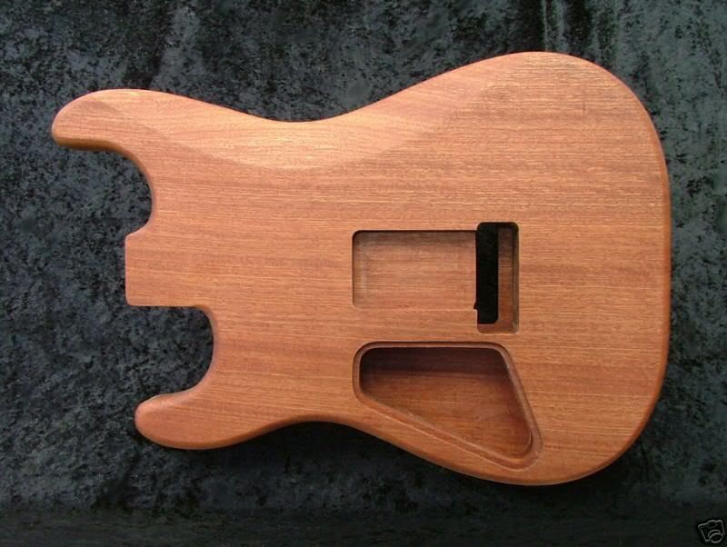

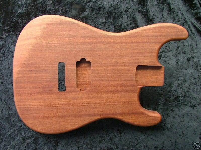

£95, which includes the drilling mounting holes for the Original Floyd Rose bridge; it doesn't need shimming to get the right trem height either, it's been routed correctly already for that. One piece Mahogany.
Here's what the luthier said about this batch of bodies:
Quote
...put it this way, the grain is so tight on this wood that it doesn't need to be filled, its almost like Maple. There's a story behind this piece of wood, its 100 year old Mahogany that came from a barn that was knocked down recently in Quakers Town PA.
I managed to get the last one he made before he ran out of the wood. How cool is that? :mrgreen:
Here's some pics:

That looks great!  A 100-year old barn, eh?  :D  It's vintage already!  ;)
I'd still grain-fill it though.  Even if he said it doesn't need it, I'd be surprised if it really doesn't need it.

I agree - it took quite a bit of sanding and painting to get a perfectly smooth surface with no grain using nitrocellulose on one of my maple necks. I'll take a good look at it when it arrives, and I'll decide whether to fill it with several coats of paint (followed by sanding after each coat), or to use grain filler.

You can tell just from looking at it that it's very high quality wood, congrats.

That looks really nice, you arent going to cover up that lovely wood with paint are you?!

Yep, lol. It's only gonna have a few thin coats of nitrocellulose though; I'm hoping it will wear through in a few years of heavy use and show the wood coming through the paint. I'm not really a fan of guitars with bare wood tbh, but I like the look of worn guitars so I won't refinish it when the paint wears away.
