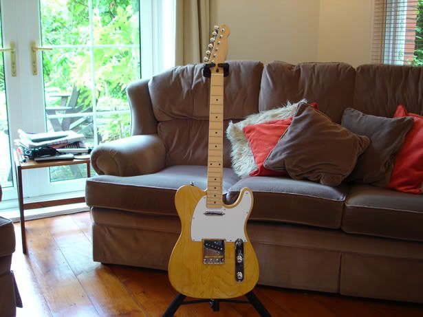

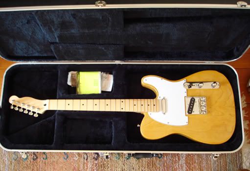

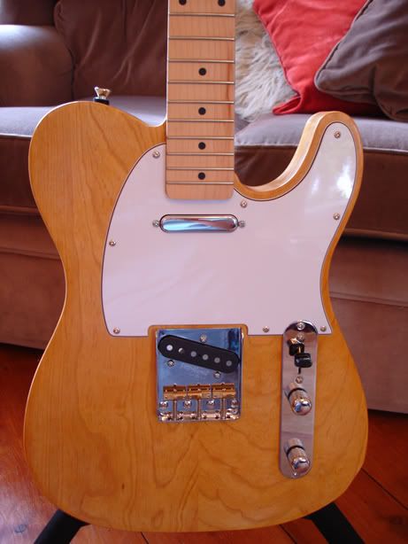

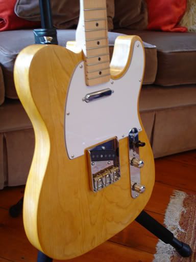

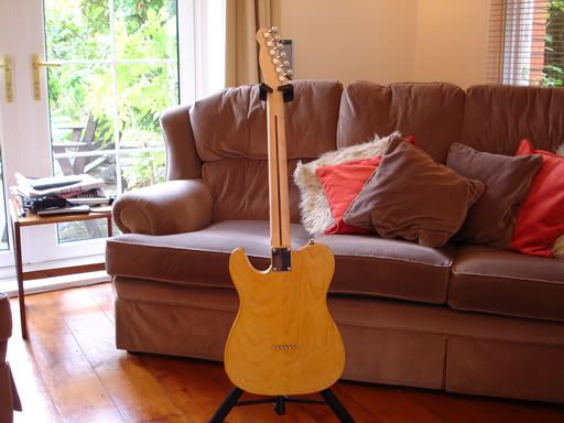

I'll just apologise for what is blatently just a show off thread, but im pretty pleased with the Tele I just built and want to show it off!!! So here it is!
A few "highlights":
-Swamp Ash body (USA custom guitars)
- One piece rock maple neck with rosewood skunk stripe (Mighty Mite)
- French Polished finish
- Bareknuckle Country Boy P'ups
- 4-way switch conversion
- erm....apart from that its a normal tele!!
One small problem is i forgot to order a string tree so I haven't actually played it yet, darnit!
If it plays as well as it looks I will be a very happy boy!

Looking good!  How much did it cost you to build, if you don't mind me asking?  I've thought abot putting one together before now but the cost has put me off.
Tele project completed!
« Reply #2 on: August 11, 2006, 01:26:42 PM »
That looks amazing, I'm gonna build up a tele whenever I finish my strat and have enough money. Wont be homebuilt (probably) tho as I dont have the right tools for the job so I'd probably end up pissing it up completely.

Cheers for the comments guys!
Twinfan, it probably cost just over £400 in total I reckon. At first i tried to keep the cost down but then thought if im going to do it I might as well do it properly and so slightly better parts.
The main costs are obviously the body and neck and the pickups. In the UK, bodies and necks are stupidly hard to come by i found. I got the neck on eby for about £90 and the body from an online classifieds for £100 which was pretty lucky, i dont think i could ahve got them cheaper anywhere. The pups were £125, but thats one of the parts where cost could be scaled down.
_tom_, I'd say go for it, the only tools you'll need are a drill, a soldering iron and some sandpaper! It was simple but time consuming to build, with the finish obviously taking the most time, its owrth doing a good job though as it can make all the difference.
To both of you id say do it as it was a lot of fun and you can have something that is EXACTLY to your specs which is always a winner!!

Very nice looking guitar.  8) Forgot the string tree..... D'oh! :lol:

the tele looks nice, very clean lines.
You can play without the string trees but there wont be as much downward pressure on the nut so you will possibly have a few strings popping out or some tuning problems.  It would certainly play well enough to test it out till you managed to get one!!
As for the tools needed to do this markbrai is right.  I am guessing he didnt route the pickups with that selection though.  It would have already been done on the body when he got it. The drill is to make the holes for the neck bolts and every other screw on the guitar.  I do use a drill press to mostly route my pickups with a forstner bit, but then i use a router to tidy it all up.
£400 all in isnt bad.  It would cost me at least £250 (seling for £500-600)to do it from scratch with those materials.  With a good setup it should easily kick the ass of any fender!!

Im not a fan of teles...but that looks realy good.....ive almost been converted 8)

Nice looking guitar- it will sound great- I just know it.

_tom_, WesV is right, the body came pre-routed and the drill was jsut for the pickguard, control palte etc holes! If I'd had to route it then...well lets just say it would be a rather light body (i.e. full of air!!!)
Oh, i hadnt realised it wasnt an absolutely neccesity for the string tree, meant i could ahve set it up today! Oh well, it should be here tomorrow so no real problem!
I'll report back once I've had a little test!

That's a beautiful guitar Mark! Really fantastic colour in the finish and looks so nice with a white pickguard too! Your others look sweet as well!
Nice bit of gear on the floor too!  :D  8)
Let us know how she sings when the string tree gets fitted!
Also I love that floor you have too!!
