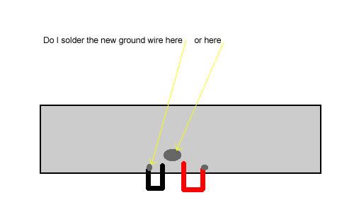

So positions 1 and 3 are behaving pefectly, but positions 2 and 4arent. I've checked the wiring about 10 times now and it is all absolutely correct according to this diagram i used (url]http://www.acmeguitarworks.com/pdf/tele_4-way_diagram.pdf[/url]).
I was just looking at it before posting this and the only thing I cna think of is to do with the extra ground wire for the neck p'up.
Ive attached a new wire, by cutting the little tab and attaching another wire, but am now wondering if i attached it to the right side of the tab?
Do you attach it to the little blob of soler where the existing ground comes back through the base plate or to the little blob located behind both of the wires (towards the middle of the plate)?? Ive tried showing this in the daigram below to try and make it a bit clearer!!
Cheers in advance for any help!!

You solder to the 'or here' point.   Are you sure you have the switch the right way round?  There is a 'common' tab at one end and if you soldered the lead pick hot to it, I think you might get what you are describing.

Its ok, swapping the added ground lead sorted it! I now have a Tele that works!!! Just got to sort out the pickup height adjustment and intonation and im sorted!
