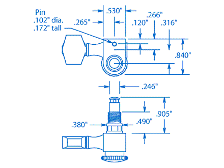

I don't suppose you would know if Sperzel locking tuners can be used to replace non locking Sperzels without any hole drilling ?

I'm 95% sure they'll be direct replacements Rob, it certainly looks like the locking pin thingy is in the same place.  But I'm judging from pictures - I've never owned the non-locking ones.
Here are the specs for the locking version, if it helps:
