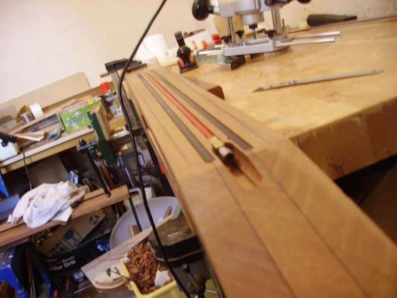

If you can install CF bars you can install a modern truss rod like this:
http://www.stewmac.com/shop/Truss_rods/Hot_Rod_Truss_Rod/Hot_Rod_Truss_Rods.html
I prefer to do both and have a neck i know i will be able to use in a few years time.
like this:
All you need is a router with an edge guide and the right sized bit, you route the slot whilst your neck is still rectangular, before you cut the shape.
Also.. dont build a guitar to save money - it never works that way :wink:
edit... is hould point out the truss rod is upside down in the picture - if i left it like that the adjustment would be backwards

Thats fine and works to a point, but if the neck ever does need adjusting its toast - and there is more chance of it needing adjustment since its the first one you have made.
Honestly - dont do it without a truss-rod.  Ones like the hot-rod or alumium box style work great and only need a straight square channel that can be cut with basic router bits and no jigs.  It is no more difficult than what you said you were going to do with carbon fibre anyway
The traditional single action curved rod is a different animal altogether - they are scary for a beginner!

Heres a little story:
I recently made a bass neck laminated from 3 pieces of hard maple and a ziracote fretboard.  It had two CF bars and a two-way truss rod like i showed in the picture above.  This neck should have been very stiff, certainly more than stiff enough for the average 4 string bass
When i strung the bass up it played fine and i was very happy . . . the next day the neck had bowed forward quite significantly.
If i didnt have the truss rod in that neck it would have been useless!  as it was all it took was 5 minutes with an allen key to sort out.
I hadnt done anything wrong, the neck was well made and built from top quality wood and components. . . but wood is unpredictable and sometimes its more flexible.  There isnt really a definitive way to know this till its carved to shape.
The truss rod is your insurance policy and well worth the extra hassle.
