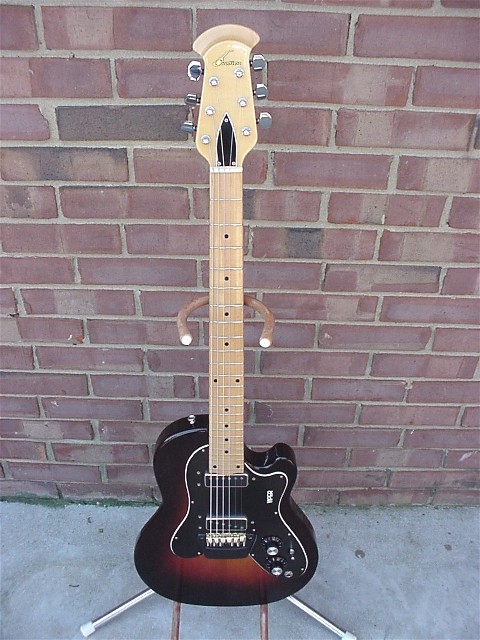

I've got this weird old '74 Ovation (electric) with some strange single coils.
It's got a maghony body and a maple 25.5" neck, just like a strat.
I play through a Marshall Plexi.
I'm not too satisfied with the pickups though, I guess Ovation budgeted quite a bit on these guitars here and there.

What type of body timber is the guitar?Could you post a pick?

The body appears to be maple (I always assumed it to be maghony, my bad).
Here's the guitar from the Ovation Archives
http://ovationguitars.com/?fa=detail&mid=1019#
Though mine looks like this, in case you're wondering:
I'm gonna add the middle pickup, but I'm still doubting wether as to get the old ones rewinded, or replace them with cream strat style....
Hope that helps, I always had the Apache set in mind for this kind of stuff, but you know the pickups better than me, so that's why I checked.
-Max-
